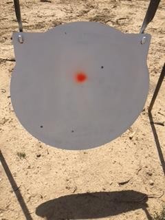

All 3 shots were with mill dead on target and it takes a little over 4 seconds for bullet to hit target.
grouping is 11 inches x 15 inches on a 22 inch target at 1107 yards.cool

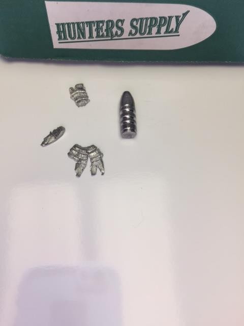

Here is recovered pieces at 1107 yard target.

Hello John
The recored is 3 shot group at 1107 yards with a 308 Texan Air gun 1.34 Moa on a 22 inch target  all shot with rifle and bipod no bags .

The quote is for reference only I have no way to chronograph bullet at target 1107 down range The recovered bullets are showing the bullet is coming into target from a very steep angel from above and is hitting the steel very hard ( I could hear the hits at 1107 yards) by looking at what is left of recovered bullets.I do not won't to start trouble on this forum over ballistic programs This bullet is a discontinued RCBS mold 30 150 SP in the RCBS cast bullet Manual number 1 is where the .271 Bc is being quoted from.

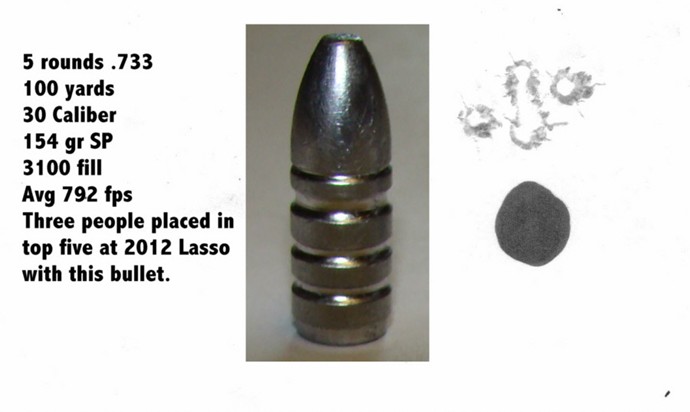

The main reason I have found for less flyers is the chamber pressure . With air guns you are only working with max 5000 psi
with firearms you are working with 14000 psi or more I believe this greater psi will force defects out to the surface of the bullet that is not visible to the eye Just what I have found from many years of shooting both.Here is a average grouping shot with the RCBS 150 SP out of air gun this can be done constantly
