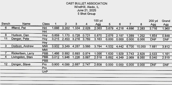

This has nothing to do with anything but just wanting to see how it would post in a thread. Anyway this is the match results from last Saturday. As mentioned before the forcast called for 94 degrees with 20 - 30 mph winds and I dont think they were far off. A 22 match was planned for after the BR match but it didn't take much convincing to call that off. To be honest I was surprised 7 people even showed up. I had a bit of a struggle with the wind but with determination and perseverance I was able to hang on and win HNT class. Of course I was the only one shooting HNT class but hey a wins a win.
Glenn R. Latham posted this 24 June 2025
I see Dan Hudson had it figured out!  He knows how to read his water bottle wind indicators.  And Pat I see you did better at 200 than 100 - impressive!
