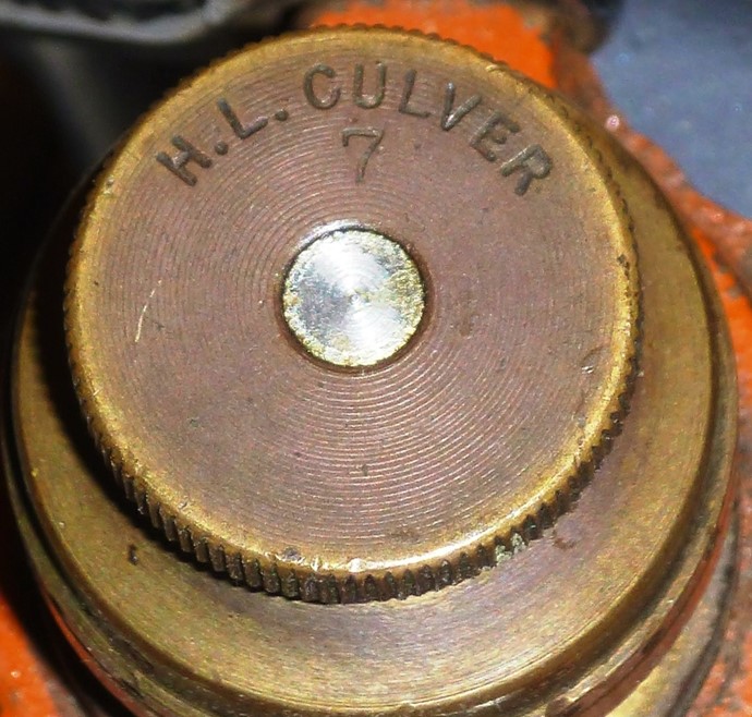

Ed Harris posted this 09 April 2017
I have several Culver conversions of Lyman 55s.
But most used is RCBS Little Dandy, which Ric made for me a custom brass rotor and lengthened drop tube to throw and settle 40 grs. of 3Fg Goex, which compresses well in .45 Colt, or .44-40 which also works well with RL7 or IMR4198 in the .44-40 Marlin  Rossi as well as for .303 Brit., or .30-'06 for “heavy” cast loads in the 2000 fps range with #314299 with those powders.
