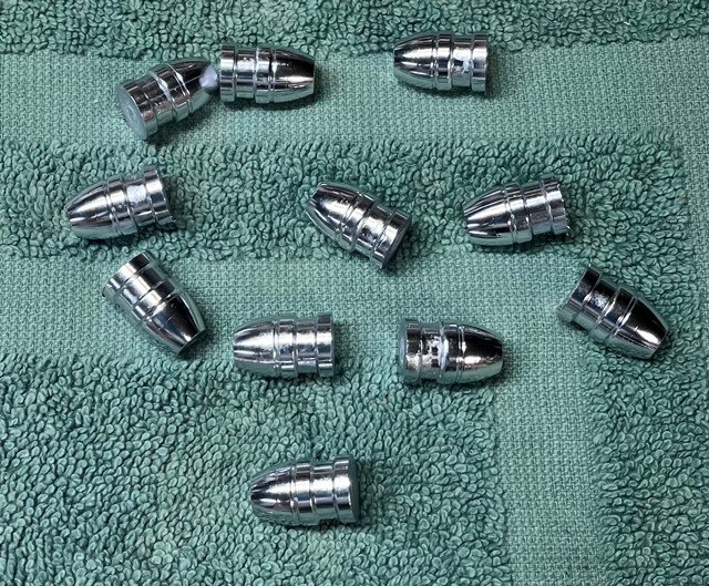

Aaron posted this 2 hours ago
After all the discussion here about the 44-40 cartridge AND latest challenge to join the Doc Pardee Club AND after watching Tod "Doc" Kesner's YouTube video "Not Any Bullet Will Do", I sent off for the Accurate bullet mold Doc recommended in his video.

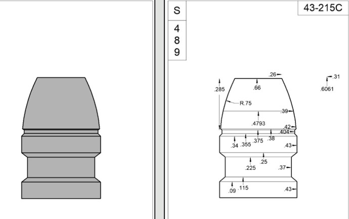

Accurate Molds is now at the 8 week delay in mold production which means they must be doing a great business! Previous molds arrived before I ordered them (not really) but now, expect the delay in shipment due to their busy production schedule. I ordered the AM 43-215C and it arrived yesterday. I got to casting with it today since we have a blessed break in the heat and humidity at last!

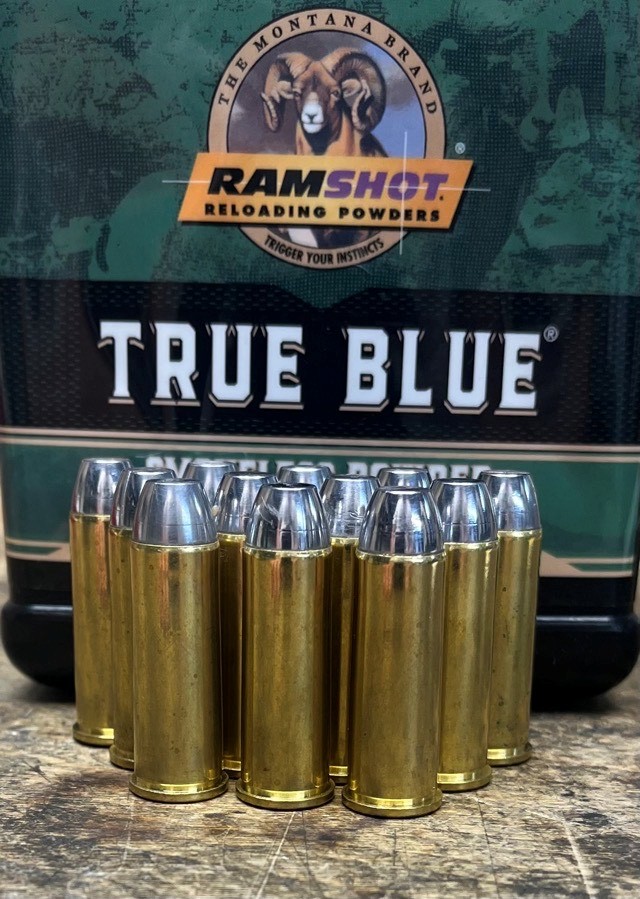

I used Lyman #2 alloy to run off about 100 bullets in no time at all. I got them lubed up this evening and loaded into some new Starline brass atop 8 grains of True Blue powder. I'll get the rascals shot tomorrow and will chronograph them as well.
After that, I'll load a bunch more to push down the 24" barrel of my 1873 rifle to see how they group. With open sights, I may find it difficult to join the Doc Pardee Club but who knows?
Idahocaster posted this 32 minutes ago
Those are some nice looking bullets, Aaron! Good luck with the shooting!
