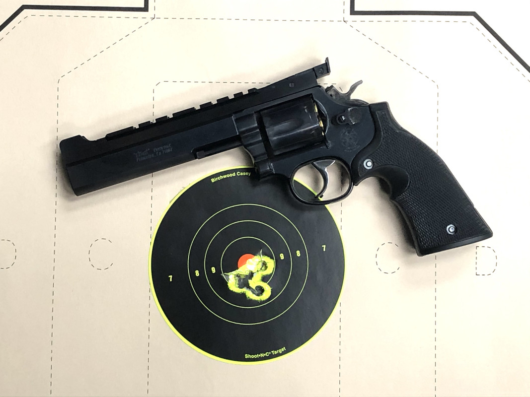

pbcaster45 posted this 24 January 2024
Here's what I do to get top accuracy from the Speer 148 grain HBWC. No bullet deformation and this load equals Federal Gold Medal Match in my Colt Python and Clark PPC Revolver.
Brass: Federal or CCI (These two brands have less internal taper)
Sizer Die: Lee Undersize .38 Super Die (Yeah! It's for the .38 Super but works great for minimal sizing of .38 Special brass!)
RCBS Expander Die with Special Order Wadcutter Expander (I got mine from Huntington Die Specialties)
CH Wadcutter Speed Seater Die
RCBS Taper Crimp Die
Bullet: Speer 148 gr. HBWC
Powder: Winchester WST 2.7 grs.
Primer: Federal 100 Small Pistol
Case: Federal .38 Special
LOAL: 1.155
Works great and should help with those fat cast bullets.
