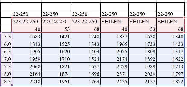

joeb33050 posted this 04 July 2018
The relationship is linear.

Remarkably linear Joe.  Nice.
With BP the over charge ends up igniting beyond the muzzle blinding and deafening the operator.
joeb33050 posted this 05 July 2018
I suspect that the relationship becomes non-linear beyond both 5.5 and 8.5 grains, but don't know.. I've seen no signs of pressure at 8.5 gr. All cases have a light coat/smear of oil, else case headspace increases-sometimes-some cases.
From this data I think I can write the relationships between MV and barrel length, (The M12 Old bbl. is 26" long, the Stevens bbl. is 22" long.); and between MV and ctg. size-223 vs. 22-250.

joeb33050 posted this 12 July 2018
Here is the data for 2 bbls, 3 bullet weights, 22-250, Titegroup..
Top left value, .853, is (INCREASE IN MV, % / INCREASE IN POWDER CHARGE, %).
Increase the charge 1%, MV increases .853 X 1% = .853%, 10% charge increase gets an 8.53% change in MV.
The bottom row and right hand column are averages.
The average for the whole is .686.
The 223 22-=250 bbl is 16.5" long, Shilen = 26" long. The ratio clearly varies with bbl. length. Ratio also varies with powder charge and bullet weight.
The published 8% looks high.
Same idea, if delta mv/delta bullet wt. = -.4, the above #s should ~ .4. They vary with delta bullet wt, and charge.
The vitavouri #s may give a clue, but they overlook relationships.
joe b.
