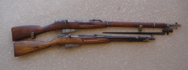

I had a M38 in a M44 stock. Bore was OK. I never shot it much so it got to be part of a trade for an RIA M1903.There is also a cut down M1891/59 and it will have the Rifle sights. Reportedly Bulgarian

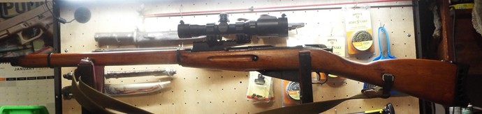

The bayonet does not mount permanently. On Ebay they have no drill scope mounts. It goes in place of the rear sight. And is rock solid. It has a cut out too. You can use the front sight.

It could also be a 91/59. I had two of them and they were a very good gun. They were cut down 91/30 rifles into m38 length. You need to post a pic and that would help.
