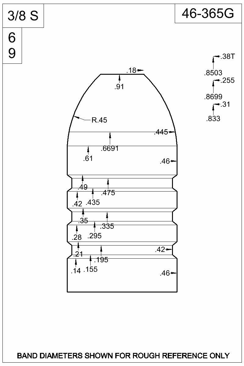

Don't have the .462 mold, but Accurate design
http://www.accuratemolds.com/img/bullets/detail/46-365G-D.png
is close to what I used if you reduced nose diameter to fit your chamber and origin of rifling a bit and tweaked driving diameters for your gun and alloy when you order.
