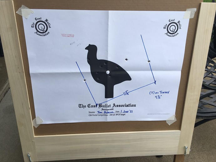

Same 32/40 and load used as in April. Target shown was shot at Iowa Territorial NMLRA match over the week end. 100yd- 5 shot. Group .912".
ML/BP cartridge May postal results
- 429 Views
- Last Post 07 June 2021
200-yards, iron sights, BPCR, same gun and load as the April entry. CSA Model 74 .40 cal. 2 1/2, Brooks PP 413-grain bullet, 70.0-grains of Old E 1 1/2, FC Lg. pistol primer.
