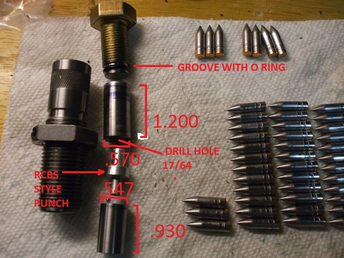

copied the pictures of the bump die made by  OU812 . but, i'm still confused as to there construction. can anyone draw a cross section diagram and post it and describe what each piece does

It's squeezes the bullet fatter and more round using a precision machined RCBS style top punch. It's actually very simple. Calibers larger than 6mm require a catch cup to extract and catch bullet after bumping. Smaller caliber bullets simply fall down thru primer slot cut in ram during extracting.
OU812 posted this 18 January 2019
Sometimes I will size down a bore riding section of bullet smaller using the NOE sizer before bumping more round. Yes it does improve accuracy and so do does the lost art of water quenching and more velocity.
Softer Aluminum RCBS style top punch works best. Some harder more brittle steels will crack and split. I use 12L14 steel for the die body, but aluminum should work also?

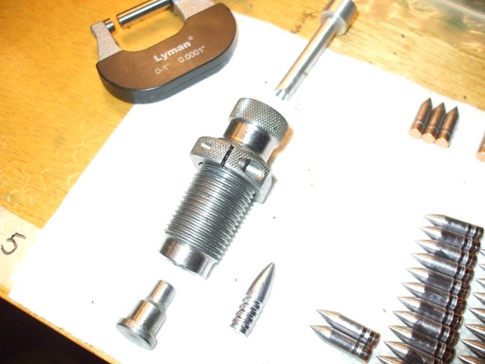

OU812 posted this 19 January 2019

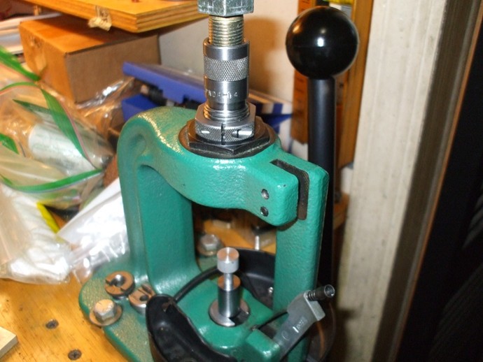

Shell holder removed and flat plate laid on top of ram to bump.
Plate removed to extract bullet. Larger diameter bullets require a catch cup machined from delren plastic.

This method works verywell with long bore rider bullets, but can also taper bump using extra step. Machining top punch for close precision fit to bore is important (.001 undersize works perfect)

OU812:  a little clearer now (almost)  i assume that the bolt is to act as a depth stop? but, why the "o" ring?     the item that is 1.2 inches long with a hole. does that act as a spacer and hold the top punch?. if so, why not make a longer bolt and eliminate the spacer? and, last; i've already started on a couple things to make push thru size dies. i annealed several shell holders. made them soft enough to turn down in the lathe. eliminated the rim notch , and turned down to a flat surface. i hope some day to be able to post pictures!

The Lee flaring die is locked down using Hornaday lock ring. The bolt determins how much the bullet is squeezed (usually 3/4 turn inward from TDC). The O ring prevents bolt from spinning in die after setting. You could machine end of longer bolt flat and drill 17/64 hole in end, but the floating spacer works best I think. Making the RCBS style top punch is the most difficult part.
Just use your imagination. You may have easier and better ideas. Such as a different top punch design that does not require drilling the 17/64 hole.
