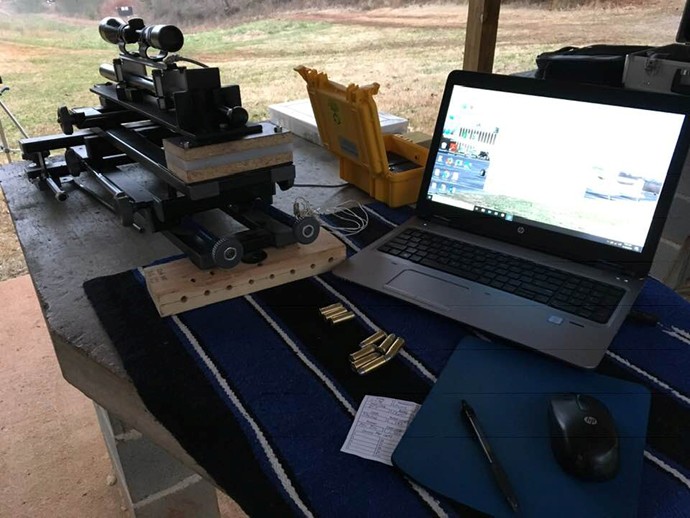

joeb33050 posted this 19 February 2019
I'd like a lotta pictures and words about that rail gun item.
Bryan Austin posted this 19 February 2019
LOL,

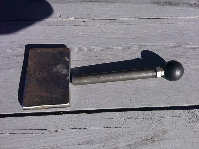

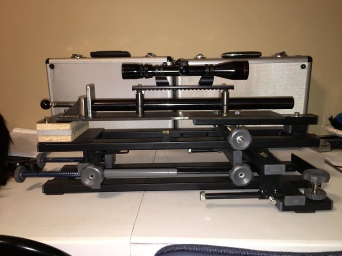

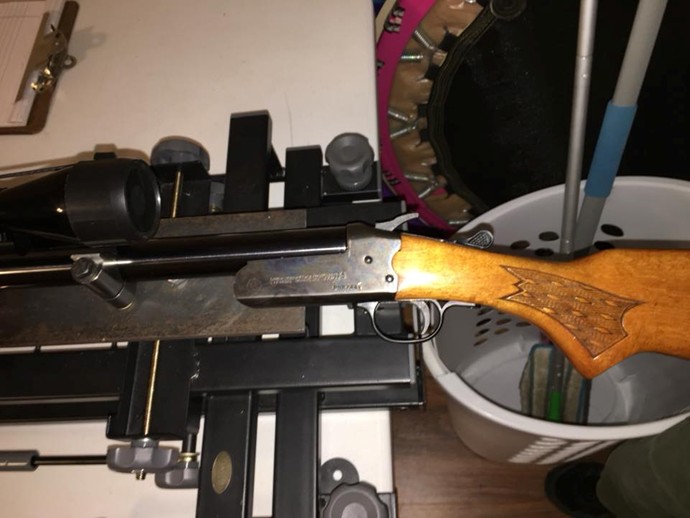

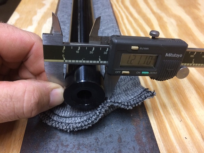

The barrel is from MGM https://matchgrademachine.com/ . It is a simple 20"x 1 1/4" Chrome Moly Blued Finish chambered for the 44-40 with a .429 bore.
The platform is a Hyskore Black Gun rest.
http://hyskore.com/products/30185-black-gun-machine-rest/

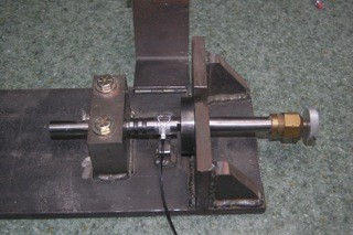

I made a base plate that I bolted to the rest and used motocross bike hi-rise handle bar risers to clamp down tha barrel, The welded up a blast plate and inserted a home made firing pin made out of spare hardware laying around the shop.

This is where I got the idea from
