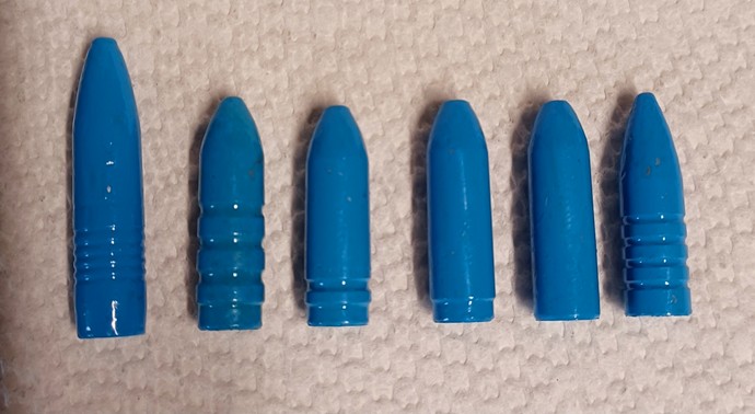

I was digging through my molds the other day and dug three to try along with the two Ive been using. The four I haven't shot before are all LBT. The smooth sided bullet was cut with one cavity plain base and the other checked for a moly coating experiment I tried years ago which is how three molds produce four bullets. It was a dismal failure. Maybe PCing it will change that, who knows. All the bullets have had a trip through a die to add some taper and range from 175 to 230 grains.

My monies on the bullet furtherest to the right, good luck on your test.

Aaron posted this 11 August 2025
Good looking bullets.
Idahocaster posted this 11 August 2025
It will be interesting to see how the smooth sided ones fare. In theory they should do as well as the ones with lube groves. Jacketed bullets are just smooth sided cores with really tough coatings!
Me too. Hope they shoot better than when they were moly coated.

My money is on 2 and 6. They just look the best so they will shoot the best?

linoww posted this 12 August 2025
I too am waiting for the results with the smoothies

The same 06 that's been beating me up by for a while. And I'm kinda leaning towards the third from the left.

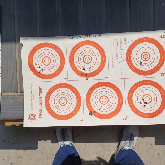

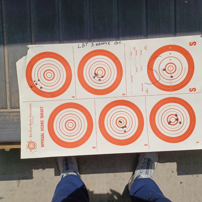

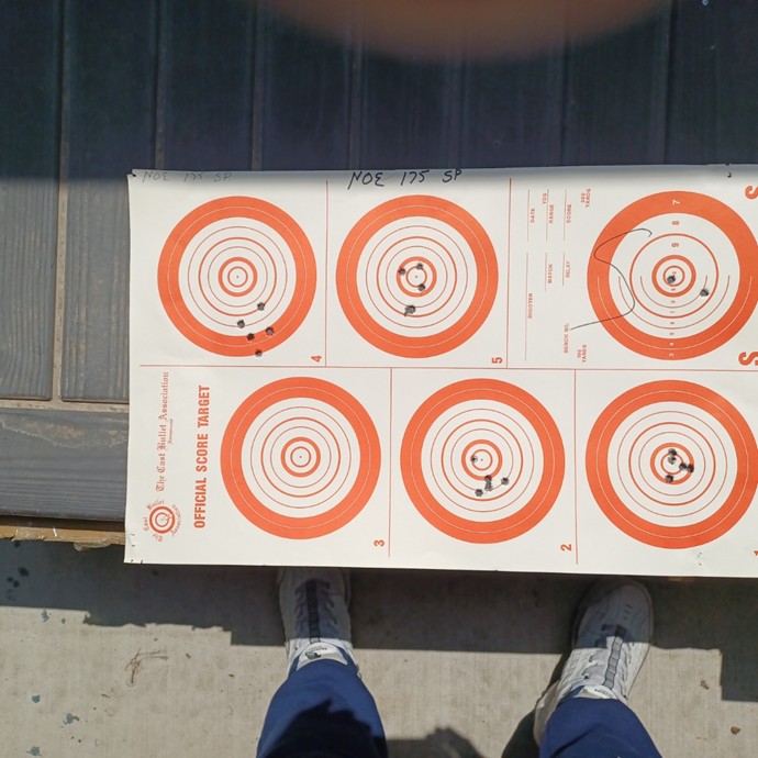

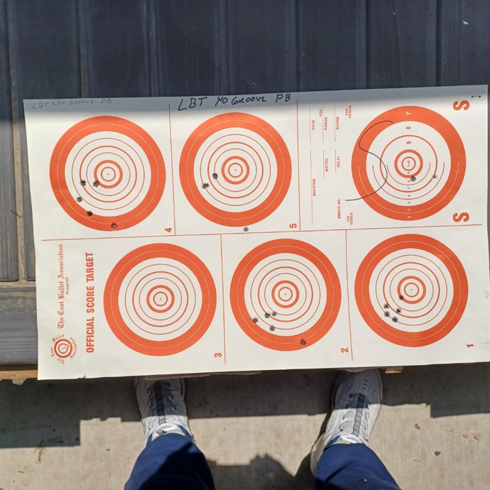

Pic heavy. The great bullet shoot off is over after 174 rounds. Didn't learn much besides a gas check mold minus the check will do half way decent. The two smooth sided bullets held there own against the rest. I think having a check shank helps but nothing but my impression to go on. I used the same load across the board. Velocities ran from 1375 for the 230 grain Lee to 1575 for for the NOE bullet with the rest a mixed bag in the middle. I think I see the heavy Lee has a slight advantage accuracy wise. I didn't want to make this a lifetime job so shot four 5 shot groups to simulate a CBA group match. The last group of the day when I was using up what was left over I used the pb smooth sided bullet and got some leading and a pretty bad group. The barrel was pretty hot by this time which might explain it since I had no.problem when I was doing the actual test.

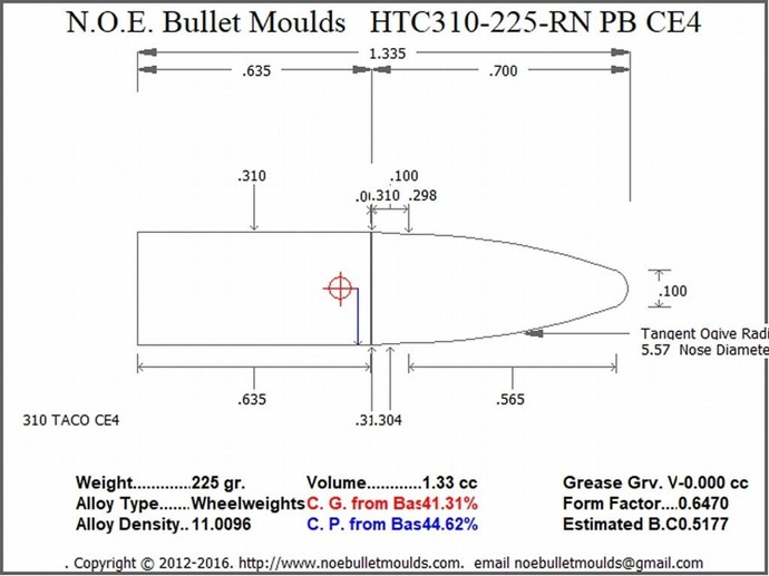

Have this mold coming from NOE to add to the insanity. 67 bucks shipped for a NOE mold? Couldn't pass it up.
