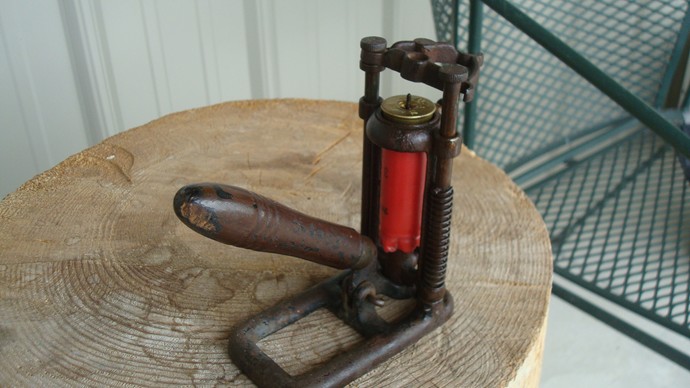

The wooden boxes were made by the old loader . Now gone, he prized them enough to house them this way. Although they all seem to be in excellent condition ( no rust ) I'm almost afraid to handle them. For sure won't use them as I would feel terrible if I damaged them in any way. To me, I see them as a great part of American history. Kind of sloppy the way I feel about these tools. Since they have made it this far, they need to be taken care of for history. Just for fun another picture of a 12ga priming/ de-priming tool , also left to me.
