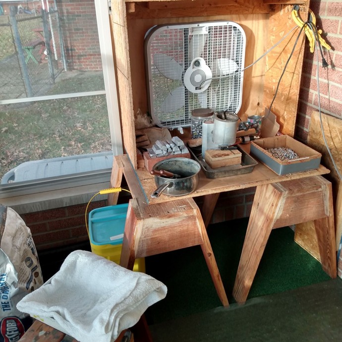

Here's my set-up. My blood levels are similar to yours. In fact, my doctor stopped testing. They send the results to the Department of Health or something but I've never been aware of any follow-up. I've always told my doctor I work with pottery.![]()

In casting, airflow relative to the source is important. Max503, your setup is excellent, the fan drawing air from behind you, over the lead pot and out the window.
