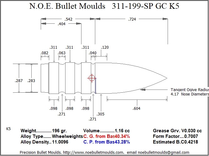

Your throat does not have a taper cut. It has a long free bore cut designed for LBT long bearing surface bullets. Veral believed in cutting longer free bore with his non tapered bullets, but cutting only .0005-.001 larger than groove diameter. You could try one of LBT's longer bullets or a bore rider with longer bearing surface to fill up free bore. I am sure Ardito experimented a lot with different designs and velocities.
I would first try a bore rider with long bearing surface something like this. Size bullet for a close slip fit in free bore and seat bullet in case very long griped at gas check area. Fitting bullet is the hardest part...maybe bore ride section fits...you want a slip fit there to. I can send you a few to try.
Pat may have some of the longer LBT designs you could try. Fitting those would be much easier and probably more accurate?
Sounds great. I just cast, gc'ed and lub-sized some xcb's from noe. They are a little short but might work well in the 14"twist. I have several bore riding molds, but the only hope for them would be if I can get the ogive into the rifling.

You really need to fill up the empty free bore area to get Max support of bullet. Seat the xcb bullet long and it may shoot, but I doubt it will accurately.
