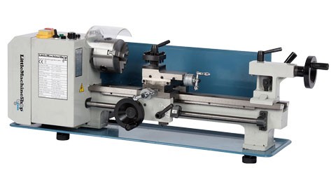

After watching videos and reading all reviews the Little Machine Shop 5100 mini lathe is currently the best Chinese mini lathe available. $899.00
  • GWarden
OU812 posted this 05 January 2017
 All Chinese mini lathes are made in the same factory, but this is there latest improvement. The 3” three jaw chuck has been increased to 4” and spindle bore is slightly larger .800". The 4” independent Four jaw chuck (optional) would be good for turning down bullet molds to shorter length. There are a few things I would like to make such as better fitting punches for lee sizing dies and bumping dies to preload bore ride bullets for better, more round fit. Lots of fun to keep my mind working and busy.
Lathe weighs about 80lbs for easy lifting. Fun Fun Fun

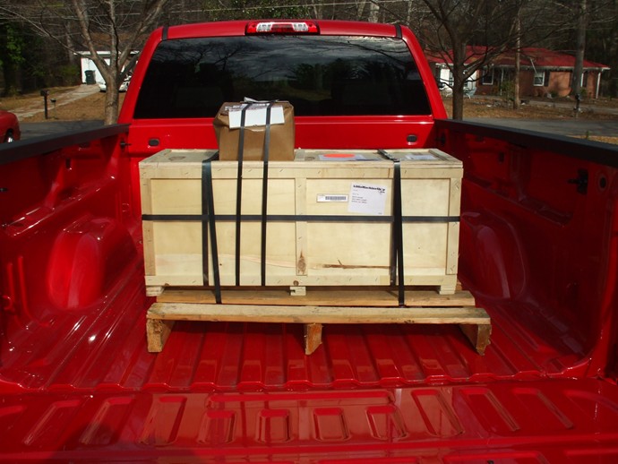

The lathe came well packed in wooden crate.

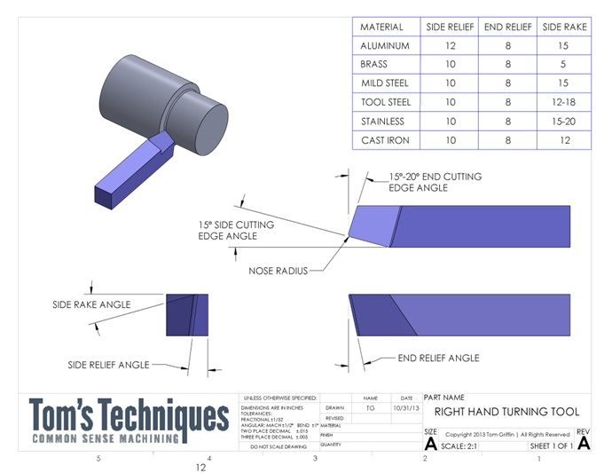

OU812 posted this 20 January 2017
This guy uses a 60 grit and 100 grit.
http://tomstechniques.com/

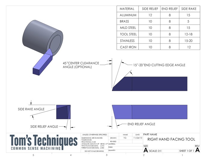

Facing bit angles.

re:  grinding tools :
don't overthink this ... angles for home shop are not critical ... just remember that the tool ” cuts ” by violently fracturing the metal as it spins ...the smaller the edge ( sharper )  the more pressure per area the tool develops .... the tradeoff is that the sharper edges will also break ( dull ) easier .
all tools actually cut in a similar manner :  set on center ... make sure only the edge touches the work ... and the work surface is going by the cutting edge at a tangent ... thus on center setting ...
leave a small radius on any cutting edge corner ... if not enough radius the tool will    scratch     ( thread )    the workpiece . the radius should spread over 2 or 3  threads ... so as to leave a smooth finish .
try to practice with aluminum ... mainly to get some successful early results to encourage you to try steel later ... many gadgets can be made from good aluminum .  also you can usually cut aluminum od without lube ... less mess .  you need lube for deep drilling in alum. tho.  always lube with steels , it clears chip buildup .
