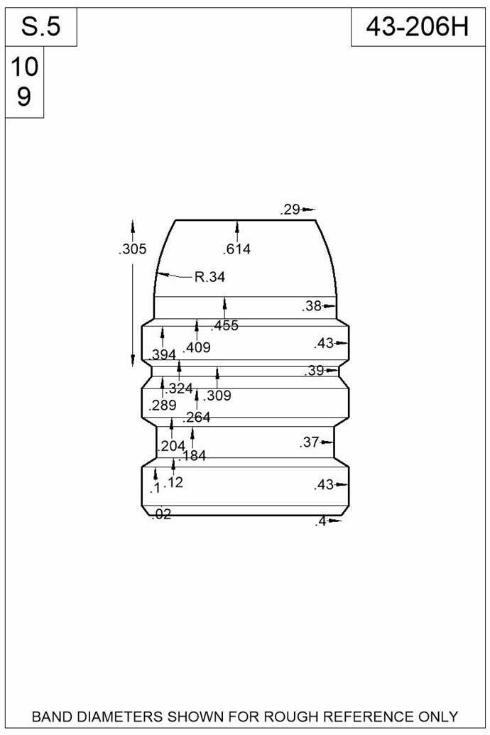

As for the .44-40, the neck is only about 0.3 long, and conventional wadcutters intended for the .44 Special when seated deep enough to chamber in a rifle will result in the hollow base being well below the neck, which could result in the skirt upsetting to conform to the bottleneck shoulder, which would raise pressure and probably also result in the skirt failing as the front of the bullet tries to move forward, while the skirt is held back, and the mid-section of the bullet then elongates to the point of ductile fracture.  If shooting these in a revolver where bullets can be seated out, such that the skirt is not below the neck-shoulder junction, it might be worth a try.
The Accurate 43-206H semi-wadcutter was designed especially for the .44-40, produces a clean full-caliber hole in the target, is accurate in both rifle and revolver, and produces factory load velocity with 6 grains of Bullseye.

  Rt now I only own 1 NOE mould and  Lyman and RCBS moulds. But this is first time I hear of Acc mould brand. I still have water behind my ears.  I'm guessing the 206H means 206gr bullet ?  Does accurate moulds have a web site? I do not see a add in Fouling shot #257 that I am reading today.
http://www.accuratemolds.com/catalog.php?page=all
Link to Accurate molds above.  Each mold is made to order, not made ahead and stocked.  The descriptors are nominal caliber, weight and last name initial of the designer.  Steve Hurst's and my molds are H along with Henry Hillbilly and who knows who else.  Modifications of existing designs may have a second letter, if somebody added a bevel base or GC.  Any of the designs on the web site can be tailored to fit your gun as to as-cast dimensions in your alloy.  Delivery is about 3 weeks.
