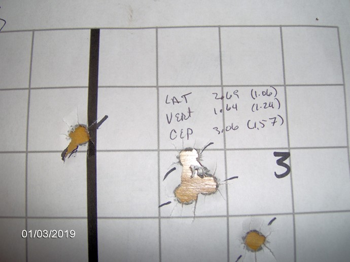

For accuracy with the 405 grain bullets I compared 2 sets of 5 rounds for groups with 3 levels of hardness: non hardened, hardened with a little tin, and hardened with a little more tin.  The day I shot was in the +20's, light wind, overcast, and shot off a bench with sand bags.  Distance shot was 50 yards.
Accuracy for the 500 grain bullet was for hard only, it just got too cold for my hands to continue, so that will have to be finished another day.  I made the decision to not shoot more this winter if the temps start with minus.
Groups for the 405 grain are shown below; all in all the most tin did the best, but this is only a small population.

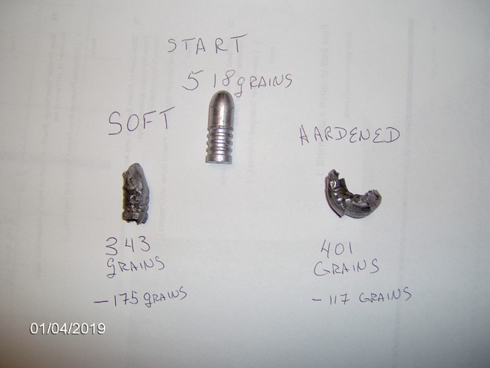

The most interesting for me was comparing hardened 500 grain penetration to the non-hardened penetration.  The bullets actually weighed in at 518 grains, all run across the scale.The most penetration was the non-hardened bullet by one flyer (25 per bundle), but it weighed significantly less on recovery than the hardened bullet.  It also had less deformation, but was skewed in the paper more than the hardened bullet.  Residue from the penetration channel had more lead specks from the softer bullet.  I think the ;more penetration was because there was less surface area presented as the lead was scraped off to allow for deeper,though modest, penetration.

tlkeizer posted this 06 January 2019
Greetings again,
Photos 3&4 are hardest, photos 5&6 are non-hardened.  Photos 1 & 2 did not come through.  Last photo is of recovered bullets with non-hardened bullet for comparison.

Urny posted this 06 January 2019
That is an interesting report, and the penetration results not what I would have expected.  That banana shaped hard bullet surprised me.  Thanks for the time and effort you put into this.

Years ago (circa 1968) I decided to test penetrating ability in some rifles available to me.  By far and away the leader in penetrating dry newspapers was a 489 gr. round nose bullet cast from Lyman #2 and fired over 68gr. of IMR3031.  As I recall it went 12 inches deeper than any other round from the .458 , .338, or 3006.  At the time I did not have the money (or desire ) to shoot solid ammo, and all bullets used were "expanding" or soft point.  Even the 300gr. Sierra Game Kings shot from my Father's .338.  None could match that near 500gr round nosed .458 slug for penetration.  The recovered458 cast bullets did not expand or even deform much.  They just went rather straight through all that newsprint until they ran out of gas.
