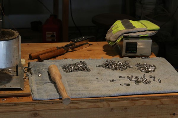

The signup sheets have started arriving so if anyone feels like sharing or discussing their groundhog ammo, here is the thread. Once again Ken the instigator put me up to it.
Here are 150 little beauties that shoot well but lead like Hades.

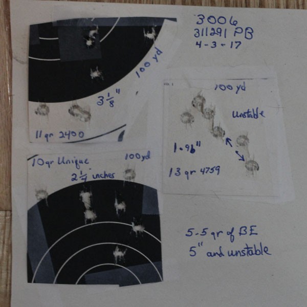

I tried 4 different powders today. The lightest load was 5.5 gr of Bullseye. This load would not stabilize the bullet at 100 yd.
I'll post some targets later.
Her
Here are the other three targets using Unique, 2400 and 4759. I will retry BE with a 6 gr load in the future.

What velocities are you seeing out of these loads?
I haven't taken the chrono out of moth balls yet this spring but I will soon as I was wondering the exact same thing. These four loads did not behave as though they were very similar. I like the Unique load and I think about 13.5 gr of 4759 will be good. I was getting a little blow back with the 13 gr load. I expect those loads to be in the 1200 fps range but I need to check that. BTW it looks like both loads will be more than good enough at 50 yards. Gotta love the 3006.
Jim
I am glad you asked. A person should always check the chrono I suppose. 10 gr of unique - 1349 fps with about 45 ES. 13.5 IMR 4759 = 1120 fps with almost 200 ES! The loads which were “out” were less than 1000 fps.
I am going to try 9-9.5 of unique. Don't need 1350 fps.
The only thing I can figure out with the 4759 is that it is extremely position sensitive with this light of a load. This may explain the tail of lower and unstable shots on yesterday's target.
I am going to chrono 12 and 13 gr of 2400 as well as 6 gr of BE. The BE load seems light but I believe that it was Ed Harris who suggested that load so it warrants a longer look for sure.

6 gr Bullseye = 1,057 fps, std=16
14.5 gr 4759 = 1,216 fps, std=28
12 gr 2400= 1,245 fps, std=27
don't forget the 10 gr of unique =1,349 fps load from above.
I believe I will increase the 4759 load to 15 gr and maybe the 2400 load to 12.5 or 13 gr.
Frankly I think any of these will be just fine at 50 yards.
