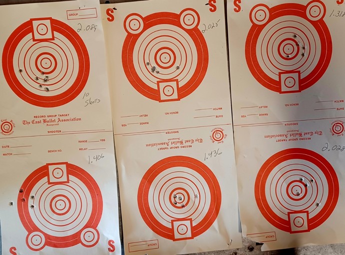

While browsing the NOE site looking to see what he had left I came upon this mold that looked like a good candidate to add to my plain base stable. It's 225 grains and while easy to cast with the only thing I would probably have done differently is add a bevel base but it is what it is. I took it out for a test run yesterday using the same load of #9 I use with the Lee 230 grainer I've been playing with lately. While the results aren't stellar I'm not too disappointed and will play with the amount of taper I add to the bullet and neck sizer buttons to see if it improves. Running a wet patch through showed a couple of small flakes of lead but no more than I've gotten in the past with both coated and lubed bullets. Average velocity for the 35 shots was 1385 fps. There's not much left on NOE's shelves but for 67 bucks shipped for a custom mold I couldn't pass it up.

Noticed only one target with the rounds in a cluster, the others with the one forever fairhful flyer. Does the base of the bullet seat in the neck or in the powder space?

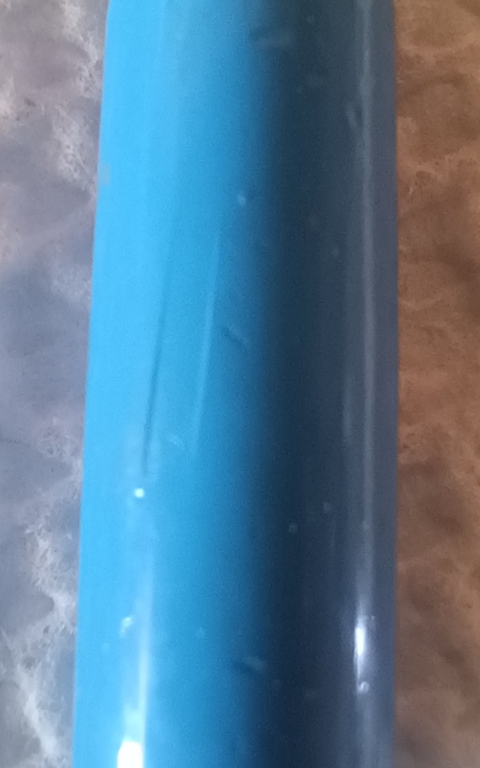

pat i posted this 27 August 2025
From the mold the bullet has a tapered section but I run it into a 1 1/2 degree taper die. So no the bullet does not go below the case neck, in fact it doesn't seat deep at all. I seat the bullet by placing it into the expanded case neck by hand and let the barrel decide seating depth when chambered. The picture shows the land marks on the bullet after it's chambered. The 06 barrel has at least 3500 cast bullet rounds through since I've owned it and it was probably 35 years old when I got so I'm sure the throat has a little wear.
