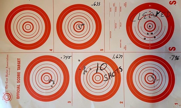

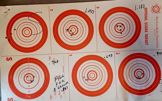

A trip to the range today with my Winchester 670 was productive. Only thing I did different today was bevel the base of the bullets with a Forster case mouth chamfering tool and dropped the velocity from the 1525 fps I've been shooting down to 1425 using #9. I dont know if it was one or both changes that made the difference and dont really care even if this was a one time affair. It was refreshing coming home with a smile for a change. I'll play with velocity a bit next time out but as of now Im pretty satisfied.

Good work shows the reward, what, if any cleaning was done during the shooting session?
Dale Flinchum
pat i posted this 13 November 2025
The target that says "Cleaned" on it was the 6th target I shot. When I saw the results I ran two wet and 4 dry patches through the gun. The other three 5 shot groups on that score target were shot after wiping out the barrel. The 10 shot group on that target was the last group of the day. I truly think if I'd have slowed down it would have been better.

Are ten shot groups forthcoming?
Dale Flinchum
pat i posted this 14 November 2025
If my range visits repeat I'll shoot some 10 shot groups. There's one 10 shot group on the top target. If the high shot, not calling it a flyer because it was probably me, the group would have been around 1.300. I could live with that. 10 shot groups aren't normally on my range time agenda. I'm more a 5 shot group shooter. Might not give the full picture but full enough for me. At least it's better than the 3 shot groups I see a lot of guys shooting down at the range.

Most don't realize that an accomplishment is it to shoot an agg. of 8 five shot groups that averages .86 with a factory rifle and cast bullets. Most shooters would rather talk of individual groups and forget the bad groups. We seldom see that level of precision in either factory rifle class at the CBA Nationals.
That is an accomplishment worth being congratulated on. Looking forward to future shooting.
Thank you John. I know you've bested it shooting a .223 so you're the one that should be bragging. Now if only it'll hold together when time for the nationals.
