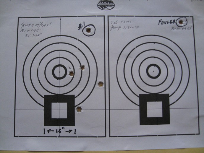

Next to be tested was the same bullet with 32 gns LeveRevolution, 2500+ lube, velocity 2177 fps.
This load behaved differently. Despite the bore having been wiped recently with Ed's Red, the fouler went about 4 ½” high and, more unusually,  the first shot of the group also blew out high. The shots are circled in the image.
The next shot and the rest of the shots were down where they should be. The group without the first shot was under 2”. Tentative conclusions – 2500+ lube requires a different preconditioning, and may need more than just the single fouler before shooting the group. So far, this combination does not look like a good proposition for clean barrel hunting.
The next group was at 200 metres (not shown), same load, the barrel having been preconditioned by the previous six shots. Group was a whisker under 6” and a couple of inches low on my estimated sight setting.  Leaving the barrel uncleaned for longer might be an option if using this load. So far no sign of curvilinear group increase with distance. RPM 130,200.

I too have experimented along these lines with tumble lube and 2500+.  For me I stick with tumble lube (BLL in my case).
I clean with Ed's Red.  After a range session I clean with Ed's Red and if I'm going to hunt with that rifle I fire another fouling group of 4-5 shots and then do nothing to the rifle but put it away.
My cold bore shots go where I want them to go.
When I tested 2500+ it seemed to take around 10 shots to condition the bore for a reliable cold bore shot after cleaning.

Interesting comment re 2500+, since this is almost my first experience of it. Good grouping performance is of only academic interest if it doesn't apply to the shots that count. Lyman Orange Magic seems reliable in this regard. See my recent previous post on this subject.
I'll be hunting with this rifle hopefully from now until the end of the year, but would be reluctant to leave it uncleaned for all that time.
Send me a PM with details of your rifle and loads and we can discuss what helps them shoot. I bench mine with the receiver on the sand bag.

I have no experience with 2500+ lube. But I'll offer a suggestion anyway, for what it's worth;
I would rub some 2500+ on a cleaning patch. After cleaning, I would try running this lubed patch through the bore a few times, to deposit some lube there. Might help- I don't know.
Wilderness posted this 21 April 2024
Thanks SD - will try it next week. I plan to run another 100 metre group with the same load but two foulers this time and some bore preparation. Cartridges are loaded and waiting - actually ageing. I like to give them at least a week for the bullets to get a grip on the case necks.
Yes, I expect the answer will lie in leaving some sort of bore residue that mimics prefouling. Alternately, identify and avoid (for hunting) those lubes that are problematic. This bore treatment may be with the lube itself, or in the case of the Alox based lubes it may be with liquid Alox or similar (which I don't have).
I have already established that a fresh residue of Ed's Red seems to do the job with Orange Magic, but not with 2500+. Unfortunately I am at the end of my Orange Magic
