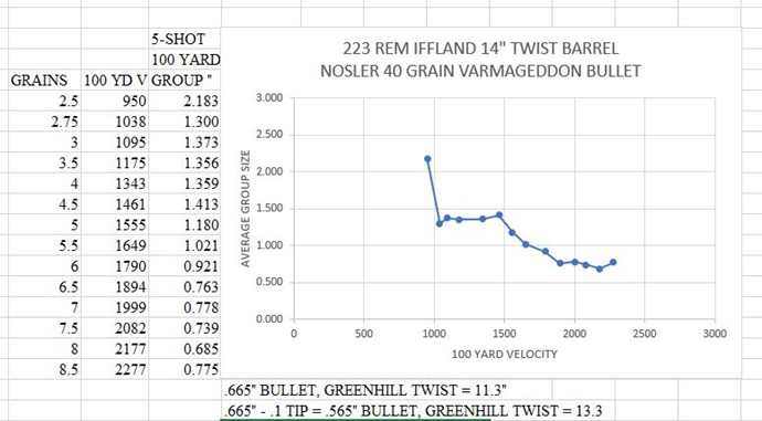

I just counted, and find that I've chronographed 208 loads in the past 18 months or so. There is NO accuracy conclusion that can be drawn from chronographed  particular loads. I write down each MV, and look at each bullet hole. Faster bullets can be higher or lower than, left of or right of, bullets of the same load.
Bullets shot with different loads, different charges of powder DO seem to vary.
This is group size vs. grains of Titegroup and calculated 100 yard velocity; accuracy DOES vary with powder charge/velocity.
So, it ain't variation of velocity WITHIN groups; it is the difference BETWEEN average velocities that varies group size.
Or, I haven't found it yet.
