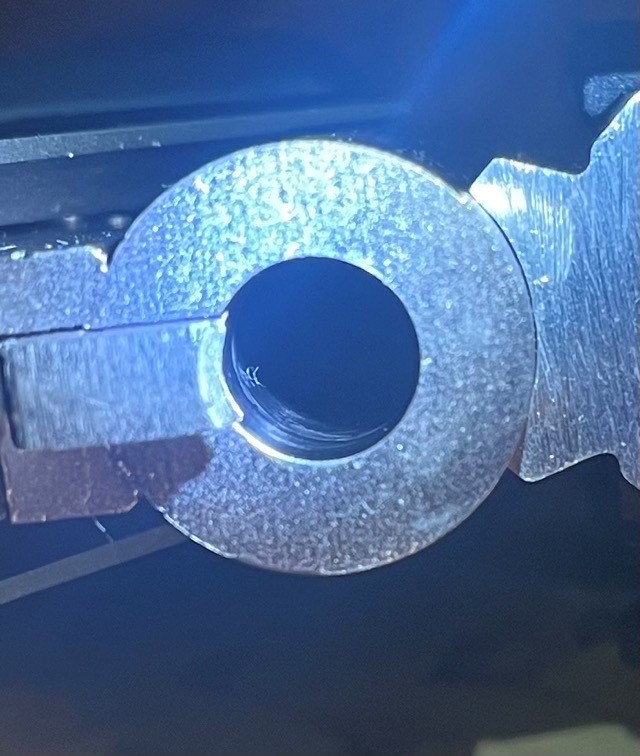

A few years ago I purchased a set of 6 T/C barrels in the Armor Alloy flavor for my T/C shooting, one of which is a .223 Remington. I finally bought an EER scope for that rascal and worked up some sizzling varmint loads for it. I got the scope doped in pretty good and while shooting those first 12 loads I noticed the chamber was pretty tight. I was having to push the cartridges into the chamber and pull them pretty hard to extract them. Fired cases has scoring all around them about 1/2" from the base. A closer examination of the chamber showed scoring marks (rings) all around the circumference about 1/2" from the breech face. That confirmed the chamber was making the marks on the brass.
I am wondering what in the world could have made those marks in the chamber. I think either the chamber cutting tool went crazy or the previous owner put a cleaning brush in a drill chuck and went bonkers in there. Either way, I will attempt to polish the grooves out of the chamber.
Shoot some ideas at me as to how you would tackle this project.

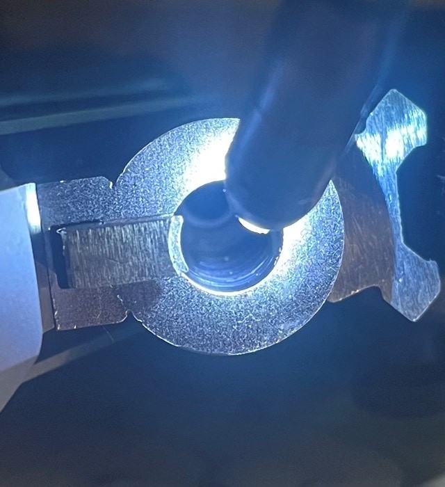

Well 600 grit valve grinding paste, a 45 caliber cleaning brush and a drill knocked the really rough spots off. That should do it. I would love to know how that happened though. Factory or a goober?

One would hope something that obvious would be caught by factory QC! If you are not the first owner I would bet on the goober.

Talk about a bad chamber, a friend had a Handi-Rifle in 243 Win. It shot really well but a cleaning rod was needed to extract the fired case. The entire chamber was galled. We bored a fired case and threaded it for a bolt and used a drill and fine compound to lapp it out and then polished it a bit. It still looked rough but the cases ejected fine.
Looks like a factory goober to me. Some of the new economy rifles tend to have the same thing. I have cleaned up several chambers that looked like yours. I have used brush with a patch and compound or some crocus cloth. I have even used a split dowel and crocus cloth. Always add a little oil. Most times you don't need to completely remove the scratch, just the bugger raised when the scratch was made. Don't go wild, go slow and do as little as possible to let the case extract. I use a variable speed drill on SLOW speed.
It's worth your time to polish and shoot a few and do it again if necessary. You can polish sizing dies the same way.

Probably first Monday morning chamber job.  Allowing chips to clog reamer.
