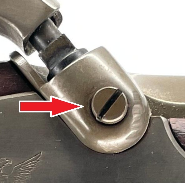

I have a 30 year old Euroarms (Navy Arms) 1858 two band with a 1:48” twist. There’s no cleanout of course. Today I gave it a thorough scrub that included the patent breech and flash channel. A 7/32” allen key will pass through the channel . I can draw a slow breath through the barrel with the cone out of it. After doing all this I held a lighter an inch from the muzzle and blew it out with a CCI cap. I have 100 Schuetzen caps that I have been holding in reserve. My local shop carries CCI’s so I like to use them. Most places so far sell 200 primers. Shipping and hazmat makes this unrealistic for me.

I was using a no.11 cone but the bolster threads got so buggered I had to goto a 9mm threaded cone. The CCI magnum no.11’s were perfect.
Besides cleaning everything I could imagine I noticed that the hammer was off to the side of the cone enough to possibly keep all of the flame from entering the channel. I bent the hammer and filed the top of the cone to make everything square and today it ran like a watch.
