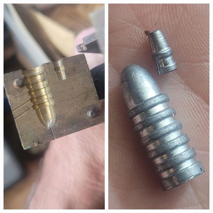

here is a .14 caliber mold for a .14 /22LR Alton Jones made up. It's companion is a 32 caliber to help keep up mold temp.
Zow! What do you load that with, pair of tweezers and a magniflying glass? LOL
