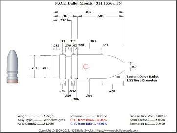

A smooth running gun will function well with the Lee C312-155-2R, Accurate 31-160H, or NOE 311-155FN using the above charges
