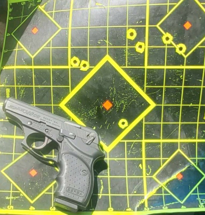

I picked up Bersa's 380 in compact form used for a song.i owned a Thunder years ago with good results but it went down the road.This "Concealed Carry" has nearly non existent sights but fits in a pocket nicely due to its abbreviated and rounded profile. With factory  stuff it's been reliable and hits point of aim surprisingly.I found I had the RCBS 90 RN for the 380 so I cast up a pile and  loaded up 100 with 3g of W231 .It was a pleasant reliable load.I shot both powder coat and regular lube and accuracy was identical.
Silly gun but at 7 yards it blows the center out of what I aim at.
 I see load data for 120g bullets,has anyone shot these loads?
this picture is at 25 yards offhand the day I got it  with CCI Blazer ball ammo.
it may not impress you dedicated pistoleros but I was proud of that group.

Nice looking pistol.

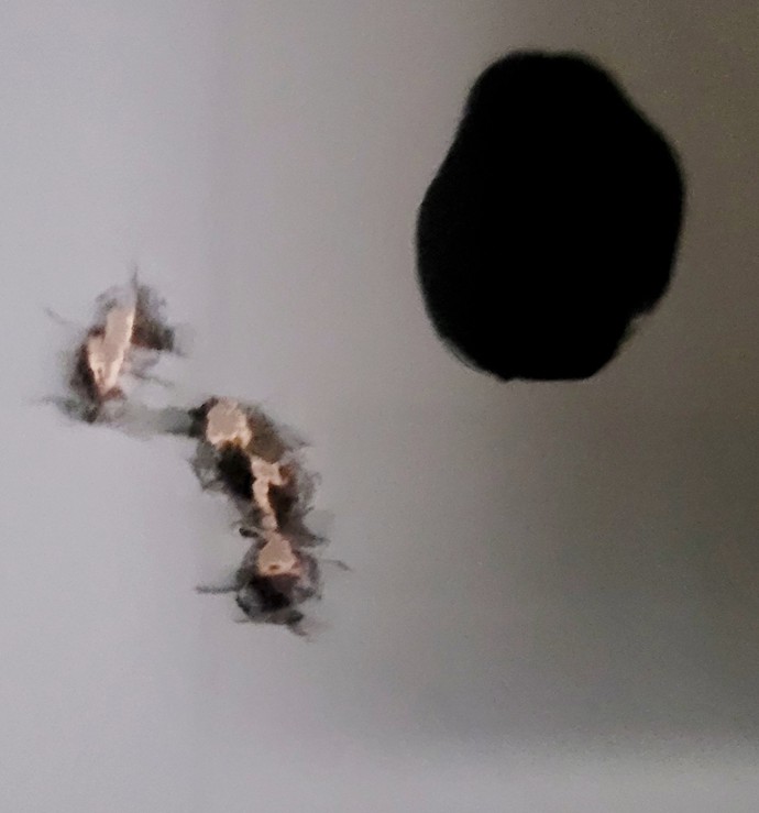

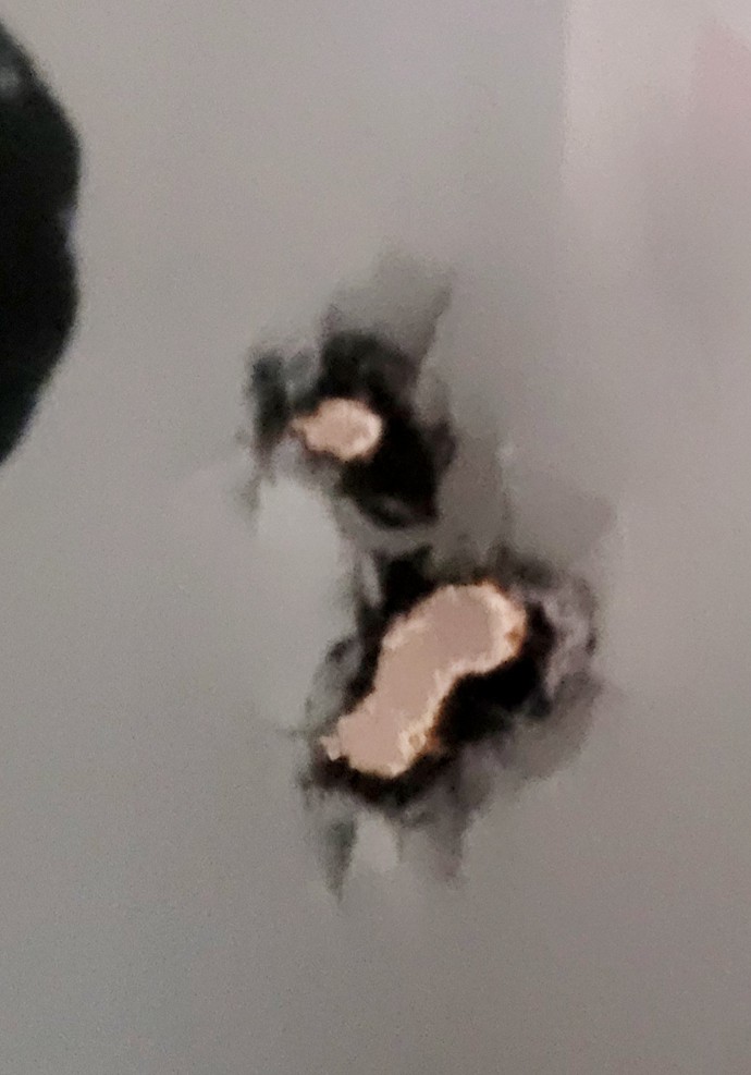

linoww posted this 18 February 2025
I ran 20 with the Lee 124 out of the Bersa with 2.2 of W231.Accuraccy not that good at all and recoil much more than I cared for. After those shots I fired two rested groups at 5 yards with the RCBS 90g bullet and 3.0 W231 and was quite happy with the results.(groups attached) When I shoot it offhand my point of impact is pretty darn dead center,rested it's always to the left.
