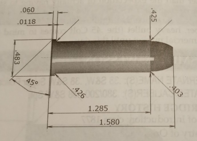

Idahocaster posted this 24 September 2025
My copy of Ammo Encyclopedia, 4th Edition has dimensions for .401 Power Mag:
I'm not sure how reliable these guys are as some of the things they say are downright false (i.e. they claim .38 Special was a development of .38 Smith and Wesson), but at least it is published data.
  • mashburn

mashburn posted this 25 September 2025
I'm glad you had that original .401 case reload. I started making a form die while the gun was in transit from the seller. I was using the .426 base diameter that is given in all of the information that I found on the net. When I received my revolver and measured the back of the chambers, I was suprised. My die measures.426 at the base,but the case springs back to.427. The sizing of the web to .427 is a lot harder that sizing to .430. It would have been much less work to have waited until the revolver arrived.
