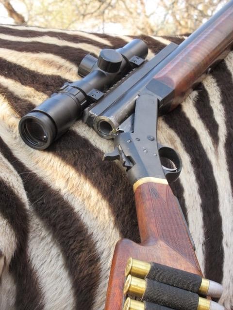

First, I have a lot of people to thank. In about march of 2015 I took up casting as a hobby. Lots of good folks on Cast Boolits and CBA taught me most of what I know now about making a good, strong hunting solid for dangerous game.
Also, two great guys, Sam Rose, and Ed Hubel helped me greatly with developing the loads for the 577 NE. ( Ed calls it “The 24 Gauge From Hell”  Good name!)

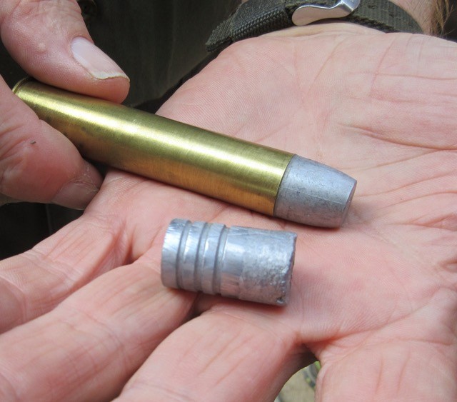

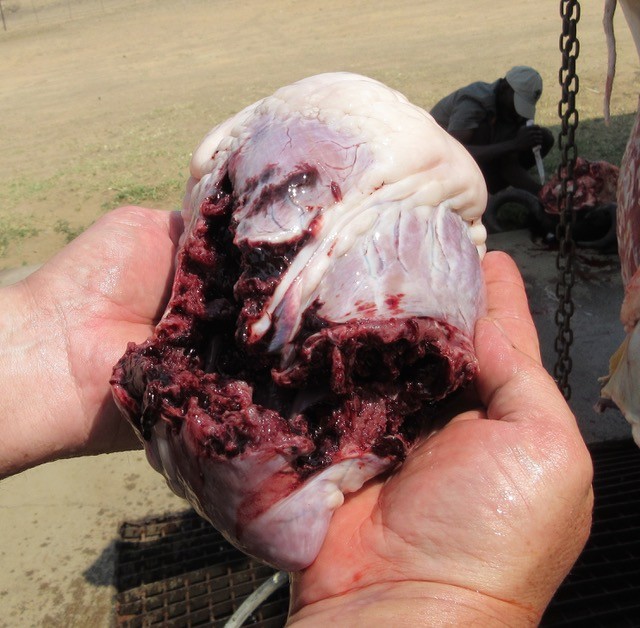

1.  "Cast bullets are not good enough for DG.”  My cast bullets performed flawlessly on all three buffs. They held together with a wide flat meplat exactly the same as I have experienced with North Fork and Cutting Edge Bullets which are amoung the best in the world.  They would break the shoulder , rip through the heart and stop in the hide on the other side ,losing only about 10 grains of weight.( I will get photos up later. Also, I will dig out my alloy formula if anyone is interested but I think just Lyman #2, heat treated would make a heck of a DG solid.)

Converted H@R Shotgun!!                                                      Works on Zebra also!
Heart damage of a cast .577 bullet after breaking cape buffalo shoulder.
  Recovered cast bullet as good as any custom dangerous game solid bullet on the market.

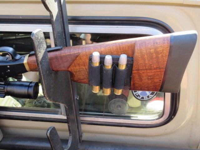

Each buffalo took one cast bullet to kill. ( 700 grains at 1800 fps.) I will get photos up with the help if some good pal on CBA. There is a video of the hunt on You Tube, as I mentioned on a post on the old forum format. ( Please just go to You Tube and type in the search box, “Brian hunts cape buffalo.” Please remember to click “like” to help me.)

What can I say, you obviously made it work.  A double rifle would be heavier, so would kick less, and would offer a second shot if you needed or wanted it, but these tend to cost as much as a decent house.
I have to wonder how many rounds before the scope is damaged by recoil - I would think this little rifle comes back at you pretty hard.  Jeff Cooper preferred a "ghost ring" peep sight for this sort of hunting.
