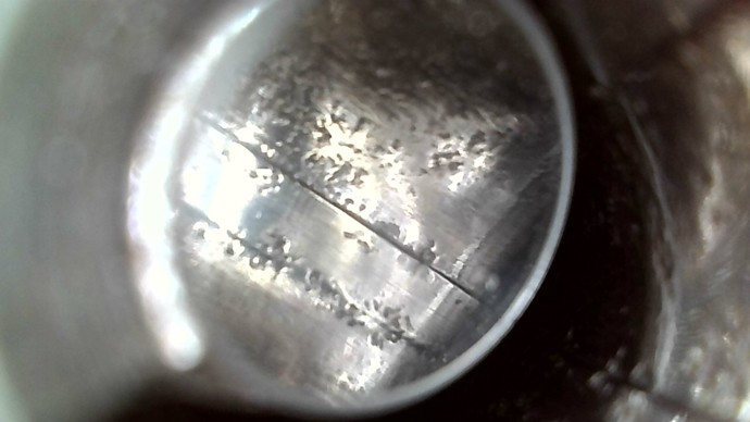

Who’s the authority on what we see looking down our barrels with these devices.
I’m seeing what is described on a website advertisement as barrel pitting. I have spent over a week with one rifle trying to clean it. I feel it must be embedded lead because some areas actually cleaned up. Other areas look no different. This made me check all my barrels. The ones that I have fired the most with cast alloy bullets all look this way. I know nothing last forever but if this is lead there must be a way to remove it.

Have used choir boy, steel wool and many different solvents. Soaked overnight and started stroking the next day. Some improvement as some ares now look good. Other areas still look the same. No copper or carbon. Just what is described elsewhere as pitting.
Solvents have NO chemical ability to remove lead! That's is the reason in the old labs, counter tops and drains were lead. They can seep under the built up carbon and "lift" the lead to be pushed out.
Outers "foul out" is 100 effective at removing lead.

Lots of good replies and I’m basically agreeing with. My concern is whether the pitting is pitting or is it hammered in lead. As I stated nothing last forever but every one of my barrels that are past the theory of good accuracy indicates they are pitted. Lead being softer than steel why would this happen. Pitting is said caused by condensation I first noticed this is my 250 Savage that was past down to me from my father. I took my first deer with this rifle. I remember growing up and bringing this rifle indoors after a days hunting. The outside of the barrel condensates . Never thought to check the inside. Even though this rifle is probably as old as I am it never got fired except for deer season. I have owned it over 30 years and put many thousand cast rounds down it. sentimental to me I always try a match with it in hunter class. I have never done well with it. It seems to shoot light plain base loads the best.
I believe that what looks like pitting is probably hammered in lead. The other barrels that look this way haven’t been exposed to the elements.
If you could post some pictures of what concerns you; it might give everyone a better idea of what is bothering you. A tale of my 2 Krags. The one with the beautiful bore doesn't shoot worth diddly but the sewer pipe Krag- loves cast. Go figure.

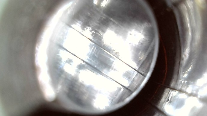

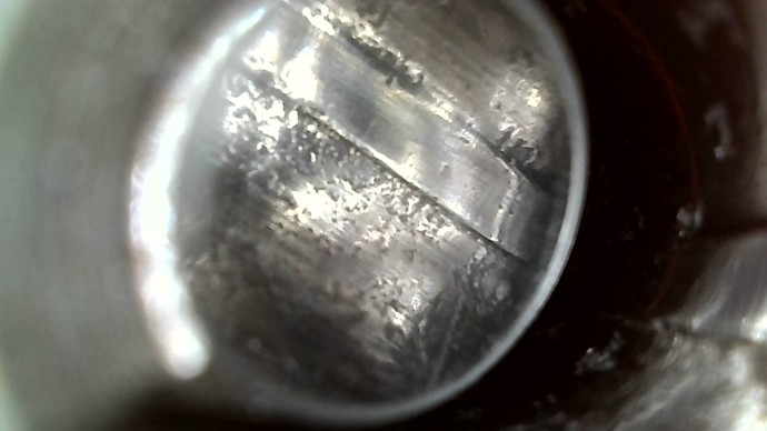

The first two photos pretty much look like most of barrel. The last photo shows area that cleaned up. If it were pitted it wouldn’t have cleaned up. Looking closely it appears those pits are raised areas with pockets. I might be wrong.
