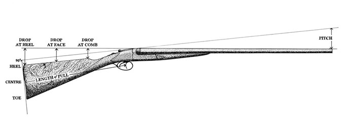

The “drop” of the stock will affect how you mount the firearm and how much recoil you will experience. The “drop” is the distance from the bore axis to the heel of the stock. The shape of the stock base can be important too. Flat, angled, and crescent all have a purpose.
