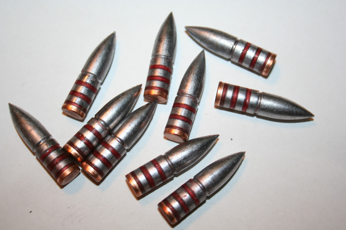

Thank you all for the help.  Ok here is where I'm at...I was digging around and actually have a LEE push through 0.311" sizer kit I got in a trade.   So I installed the Hornady crimp on gas checks on a few without any lube.  They say that's the best way so no lube gets under the checks.
Then I applied some White Label  Carnauba Red lube in the two lube grooves the passed them back through the sizer to smooth the lube evenly.
I have the RCBS expander for lead bullets that I used to prepare the case necks, also a slight chamfer of the case mouth to also aid in proper seating so the bullet doesn't shave as it is pressed into the case necks.  This worked very well as I made the DUMMY cartridge for test fitting the chamber and cycling.

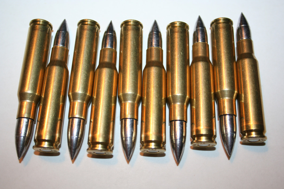

Well this is where I am, I have loaded some testers with this bullet using CFE223 powder on the lower end of the spectrum with the COL being 2.7500", Federal Magnum LR primers.

Good luck Mr. Cranston those are right pretty bullets.

At the moment I have a LEE 0.311" push through sizer some one gave me in trade, actually forgot I had it.  After I applied the gas checks and ran the bullets into that sizer as to crimp them in place.  For now I am actually applying the Carnauba Red by hand to the bullets then run them back into that die to smoot out the lube.  This is because I haven't had the chance to get the sizer for the Star.  Its a pain but I'm working my way through what I have for now!  I'll have to test the loaded rounds I put together to see how things work and how accurate they are...
