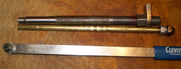

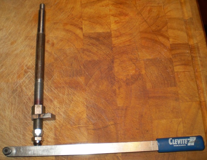

This is a breech seater that I made for a long neck, 300 Savage (308 length). It was a 24", Rem 722, Ebay barrel that I mounted on my 40X.
The anchor for the lever, I machined and mounted on the two left side screws, at the back of the action, where a rear sight would mount.
The body of the BSer is 1/2” steel. I machined a case size end on one end and threaded the other end 1/2x20. But, the only thing you really need is clearence for the case, back of the neck and a neck with a close fit.
The brass rod is just a piece of 5/16, threaded 5/16x24, with a lock nut, to adjust for seating depth. The acorn nut, is just to push against.
