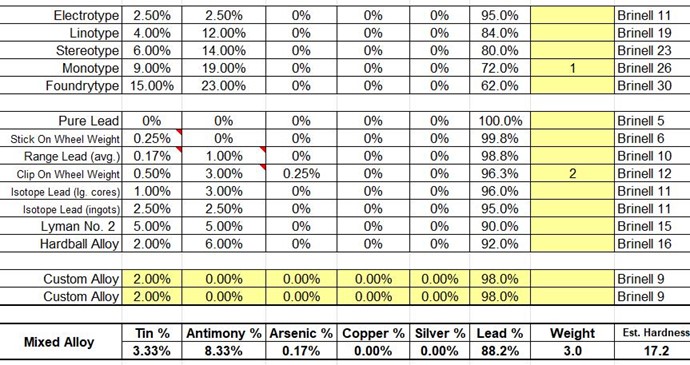

QUESTION: If I add Two parts of Wheel Weights, BHN 12.5, with One part of Monotype, 27.2 BHN, do I end up with an alloy that is 17.4 BHN ?
12.5 + 12.5 + 27.2 divided by 3 = 17.4 ???

RicinYakima posted this 11 May 2024
Go to the upper bar that says "CBA info"
Go to down to "Downloads"
The fifth one down is a hardness calculator.
Download it and run it.
Oldman 1950 posted this 11 May 2024
I can not get the Alloy Calculator to work for me.

Aaron posted this 11 May 2024
It is a MS Excel worksheet. You will need to download it to a PC, not a smartphone.
Rich/WIS posted this 11 May 2024
That mix will give you about 4.5% tin and 11% antimony, should be close to 20 BHN.
Your answer is close enough. Understand though, that alloys may not "average" like this one.
