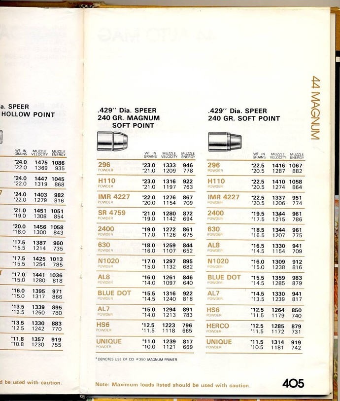

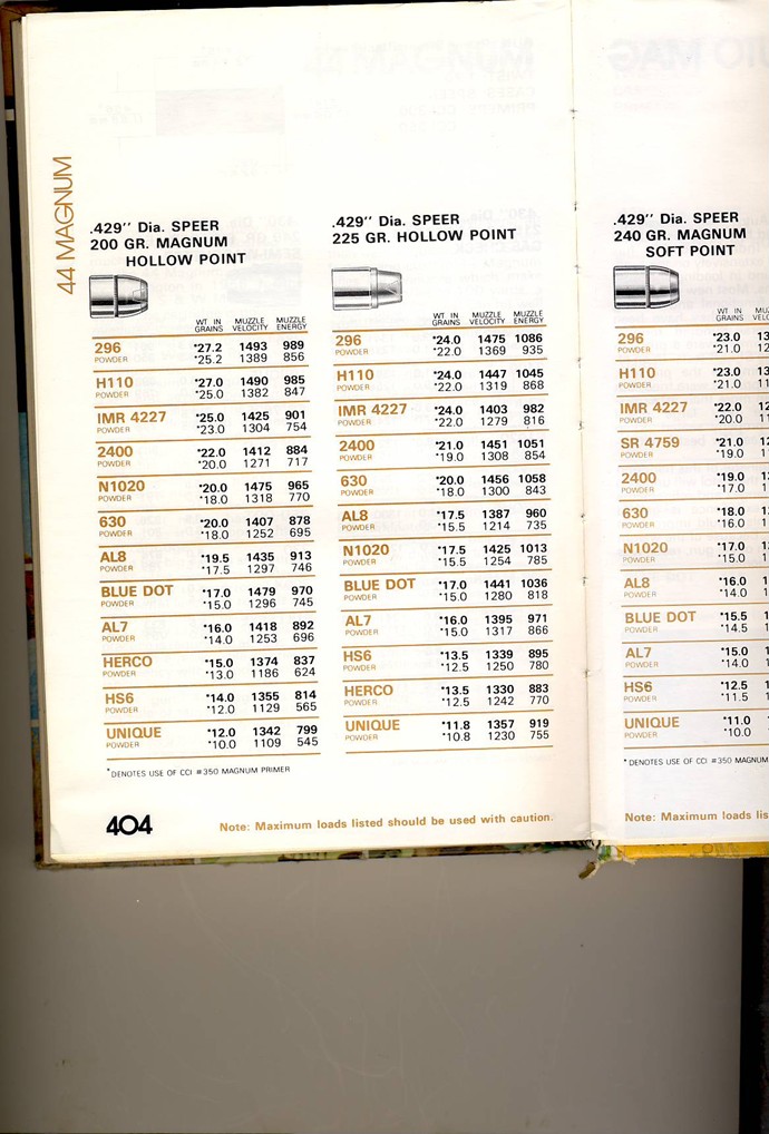

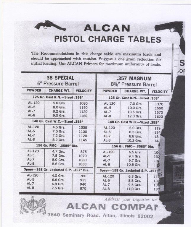

I have 38 special and 357 data
guess I will find out about posting pic's
The velocity for loads for 38 Special 148gr wad cutter look really fast.
Thanks for posting that! Those are some pretty high velocities for 38 wadcutter.
