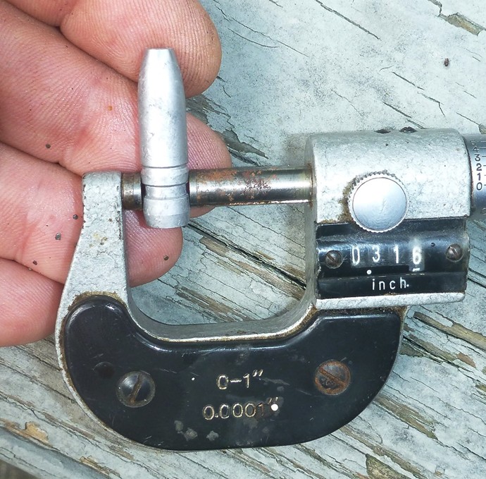

Anyhow, now looking at getting another mold. This one will be for my .303s, 7.7 Japanese and 7.62x54r. now, there are plenty of molds out there for these. I want to find an ideal one for all of them. To do this, I have to slug all the bores. Now my plan for doing that presently is to do a chamber cast . This way I can reuse the alloy on each rifle instead of having to buy multiple slugs. Just thought I would ask the experts over here first!

Well, I don't shoot any of these, but, most of them would be served at least OK by a heavy, gas check bullet a bit bigger than the usual .310-.311 diameter, not sure Lyman is still making it, but they have or had a bullet intended for the .303.  That said you need to measure the chamber throat, not the bore itself, in all 3 rifles.  Frankly I would be surprised if the 7.62x54 is not a good bit smaller diameter than the other 2, and while you can size down an oversized bullet I think you would be better served by at least 2, and possibly 3 molds, one for each rifle if they are different sizes.  If you want to use a traditional lube-sizer, you will need probably 2 and maybe 3 "H & I" dies as well.

What M3 said. When you know the diameter of the largest throat, get a custom NOE or Accurate mould heavy plus (200 grains) and what every sizers you need to make them fit. If you buy off the shelf these days, you will have to buy four or five for every rifle to finds something that fits. One right mould is less than five Lee's.

What you really need to do is make a chamber cast or a "pound cast" on each of the rifles.  One of the greatest detriments to accuracy , especially in mil-surps, is the bullet entering the bore canted or less than straight.  This bends and mal-forms the bullet making it wobble off course upon exiting the barrel.  If you don' know how to make a pound cast just holler and we will be glad to help.

Best, cheapest solution is to do a pound cast of each rifle.  Then measure and have Tom at Accurate Molds cut a bullet to fit the largest rifle of the batch. His 31-215B (GC) or BB (beveled plain based) works in most.  Of the NOE designs #316299 works in most.  Get several Lee push-through sizers starting in .314."  For rifles in which you need larger send to DougGuy in NC to hone as needed to .315, .316 etc.
Be advised that with rifles having odd number of grooves you need to wrap bore slug with paper and measure over that and subtract twice the paper thickness.  I've found that a .316" sizer works for most of my .303s and Russian 7.62x54Rs, whereas a .314" stock Lee push-through works with US M1917, and US .30-40 Krags and much-worn '03 Springfields which have been shot a great deal with jacketed bullets and have worn throats.

I'll give you an example of what can happen with one bullet. Many years ago I had a series of stock Jap Type 99's, which is the 7.7 Jap cartridge. These rifles had groove diameters of 0.313", 0.314", 0.315" and 0.316" with tight throats which is a little unusual with these....... much the same as what you're asking about. I had a good load that shot well in most Jap rifles...... using the Lyman 314299 which cast at 0.315" after ageing. I sized for each rifle which basically was a bunch of bullets at one thousandth intervals and loaded the same load in each. The results did not go along with what you read is supposed to happen though. The 0.313" rifle shot really well and produced 1/2" groups, the 0.314" rifle produced 1" groups, the 0.315" rifle produced 2" groups and the 0.316" rifle produced 4" groups. The point here is fitting the throat is not necessarily what you want as the prime thing to fit a rifle. The nose diameter and shape has a lot more to do with accuracy the what you size the body to.
