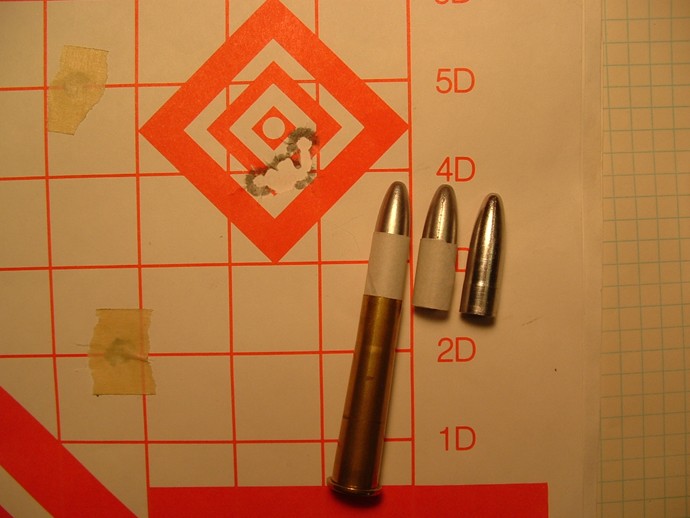

Tom A. Here is a pic of one of my DDEPP bullets (DualDiameterEllipticalPaperPatch) bullets, 40-65 load,
100yds. The bullet shoots well  out to 1000yds

Tom Acheson posted this 03 January 2020
Arnie,
Great looking group!
Scope or iron sights?
Bullet nose shape is something I've not yet decided on for my new mold. Is that shape on yours also known as a Money bullet nose?
