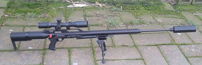

Ive been toying on and off with cast bullets in PCP airguns a couple years.There have been large strides taken in accuracy with these things.Many mold makers are catering to these guys and thought maybe  if we offered a class it might help keep the CBA matches going.
On the plus side there is no powder,primers or cases and once you get your  air source set up its the cheapest shooting to be had.If you have a bullet trap its free!
Just a thought.

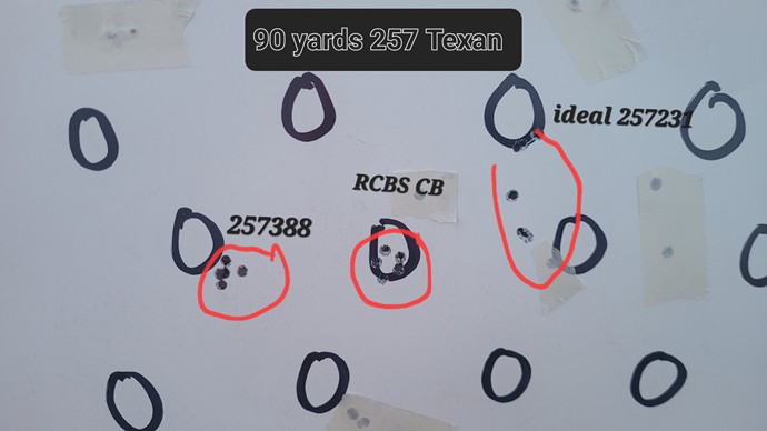

Shown is a new to me 257 Texan and the initial tests.
Note right group with too long of a bullet that was tipping. Twist is a 1-16.Bullets traveling in mid to high 900's

Those groups look like that 257 Texan might want something even shorter. the old Lyman 257420 (~ 72 grains) might do well. I ended up with an NOE 260-63-RF Plain Base that would probably be superb if you can find one. Still playing with it in a .256 Marlin 62 that keeps annoying me.
linoww posted this 26 December 2025
I tried the 257420 yesterday and it didn't group as well as the 257388,but it was pretty windy so it needs another chance. My 357 texan hates shorter blunt bullets but shoots the 200g RCBS and the SAECO 351 great.
