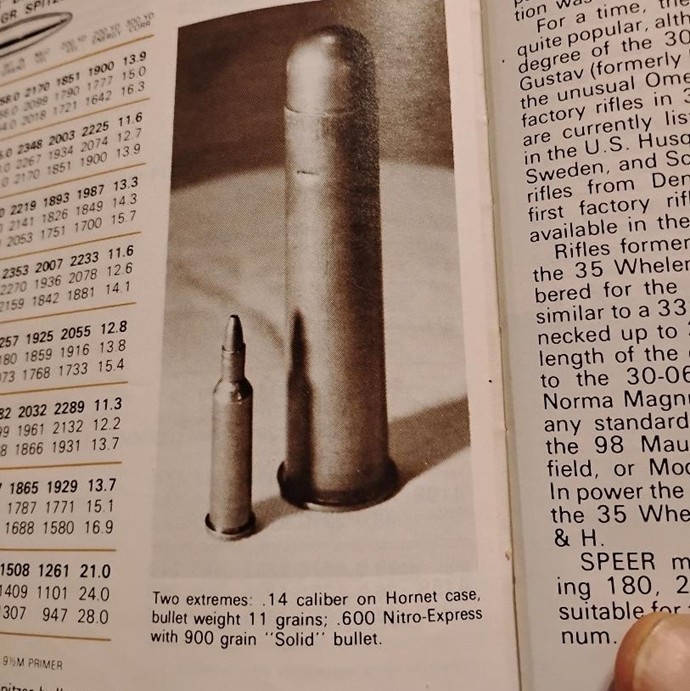

  • Wouldn't it be awesome to have one of these?
