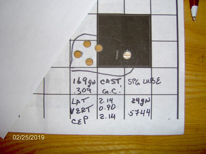

Greetings,
Well, for a guy who wrote in his own notes he probably would not pursue cast bullet shooting in his .308, I have proved myself mistaken.  I cast some bullets with a borrowed .30 caliber mold, Lee 170 grain, about 450.  Finally I got the .309 sizer and a top punch, and loaded up initial rounds to try down by the lake (no fish in it, darn it).  What I loaded was 5 each with 24 grains IMR 4227 and Accurate 5744, both loads were pretty much in the middle of the load range for the two powders in the Lyman Cast Bullet Handbook.  Cases were LC, CCI 200 primers, SPG lube applied with the lubrisizer and gas checks.  My thought was if one showed more promise than the other, I would concentrate on that powder in future loads.  Here are the initial results at 50 yards (didn't feel like walking out a hundred yard).
     4227:  Lateral 3.56 inches     Vertical 3.72 inches      CEP 4.55 inches
     5744:  Lateral 2.14 inches      Vertical 0.90 inches      CEP 2.14 inches
                 I had one outlier, it added an inch to Lateral and CEP measurement.
With this as a start, I might even be able to hit the silly groundhog this spring.  Anyway, starting on a new cast bullet venture easier on my shoulder than the 45-70.  Later I plan on getting a mold for the 25-06.
TK

tlkeizer posted this 26 February 2019
Greetings,
Sorry, did not list the rifle.  I am using my Savage 99, scoped with Nikon 4X12.
To me it is interesting that both the 4227 and 5744 loads recommended to try above are below the starting loads in my Lyman book.  I also have 4198, so in a couple weeks after the weather allows for more time at the range I may compare most of the loads.  If I do, I will post photos of the results now that I have figured out how to pull the pictures from my library.
TK

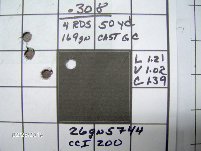

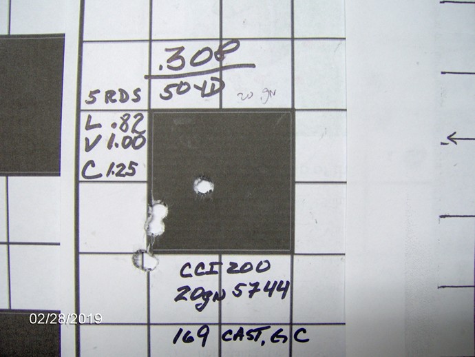

tlkeizer posted this 01 March 2019
Greetings,
Went out to compare 5 loads with 5744, I will try 4227 later after I get back from a trip.  I shot 18-26 grains in 2 grain increments, the 20 grain load did the best.  My 24 grain load was pretty much the worst, not nearly as good as the photo above.  Interesting that is shot well one day and not another, may have to adjust the shooter.  My 3 best groups for first time dedicated to finding a "good" load are included below.
Sorry about two of the same image.  Tried to remove the second but to no avail.
TK
JeffinNZ posted this 01 March 2019
Is it my imagination or do some of those holes look a shade oval?
Greetings,
JeffinNZ, In the top photo, the 20 grain load, the bottom hole that is elongated is from 2 rounds overlapping, the next two above it are almost overlapping.  In the bottom photo some look slightly oval in the photo, but were more round "live".  I had to hold the camera somewhat askew so as not to block the light coming in the window, using a flash caused too much wash out of the image.  Also, some of the paper was backed by the cardboard box, some of the paper had no immediate backing due to the box lid folding and a lot of holes in the box from previous range outings.  So far the bullets have not tumbled, at least not out to fifty yards.  100 and 200 yards may tell a different story.  I have noticed a difference in the holes caused by paper with cardboard right behind it and paper with air space behind it.  I may have to use a new box when firing for record as the holes are much nicer with solid backing.
