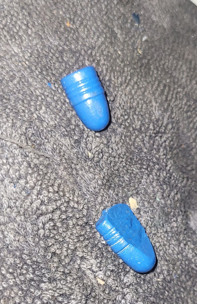

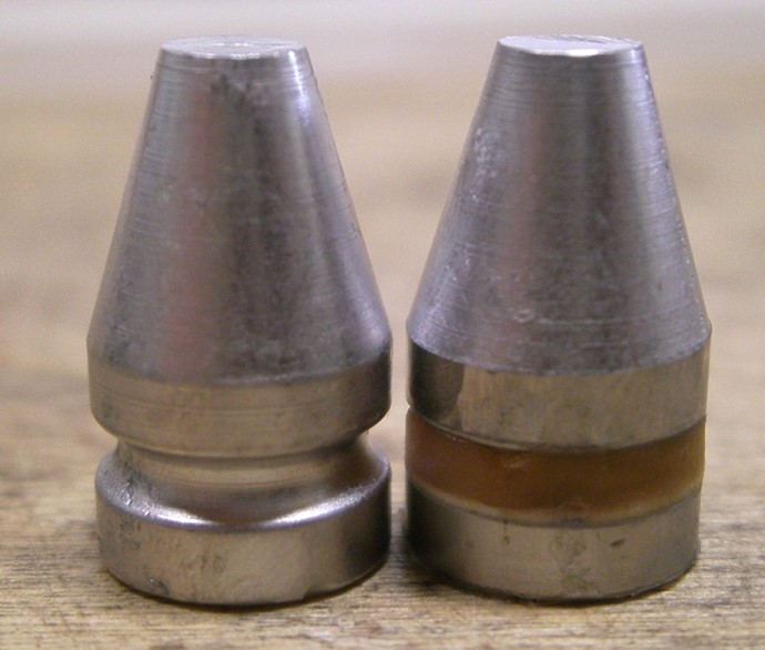

A member in the forum sent me some powder coat bullets to try in .45 and .32  and they worked quite well. I Had some powder a  guy had given me years back I think he bought off somebody on the "booooliiit" site so i coated  my own bullets. I had good luck in a couple revolvers. I decided to try it in my AK47  of pistols the Ruger P series 9mm.Ugly ,clunky but reliable with about any junk I throw at it.

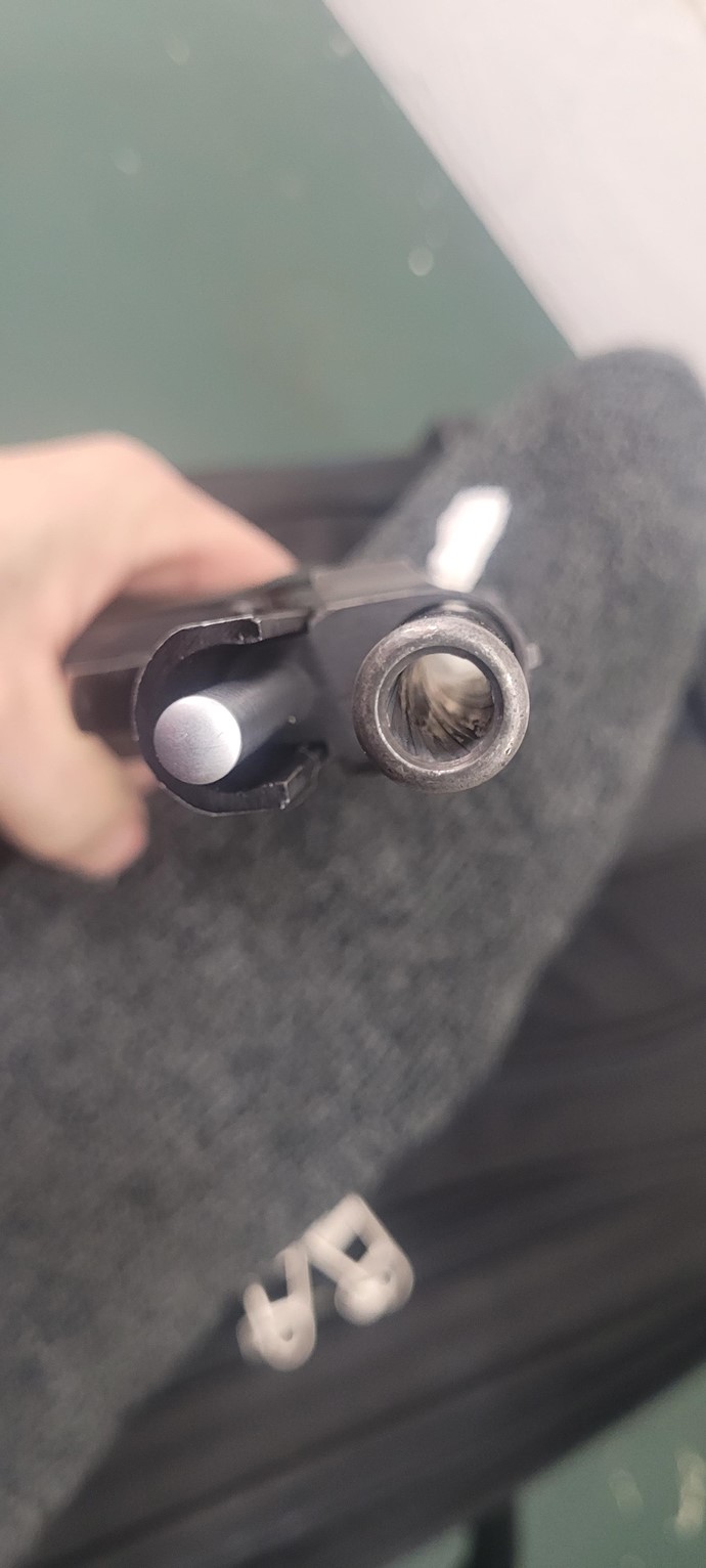

Bullets were or slightly under .358.Load was 3.8  Greendot dot and 2 range sessions the barrel leaded  like you wouldn't believe.I hadn't thought powdercoat was supposed to lead barrels ?
I used the exact same coating  procedure that  has worked for about three hundred rounds in my  revolvers. Some of the loads are in the same velocity range as this 9mm.
Here's a picture of one of my bullets and also one I smashed with a hammer to show that that stuff is not coming off.

bullets are sized after coating and come out .3575. I've shot. 358 in the 9mm Ruger in the past. I just got back from shooting a Beretta 92S with the same loads and same exact results. In fact after about 15 shots the bullets started tipping. Barrel completely full of lead.

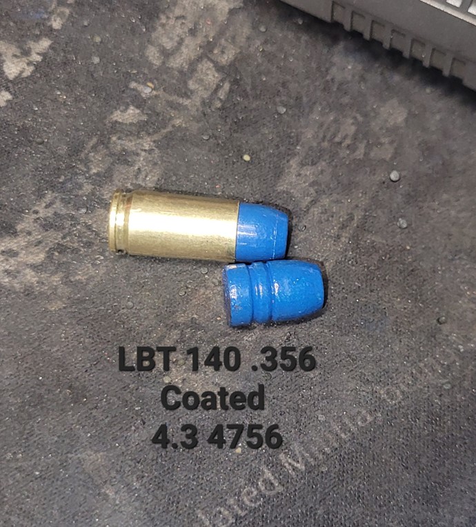

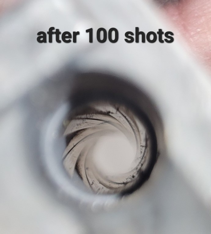

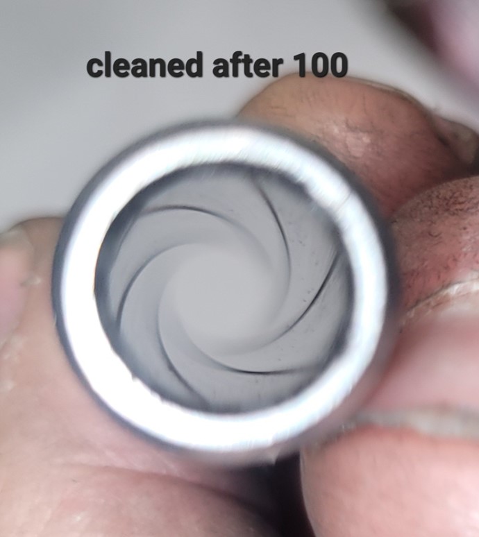

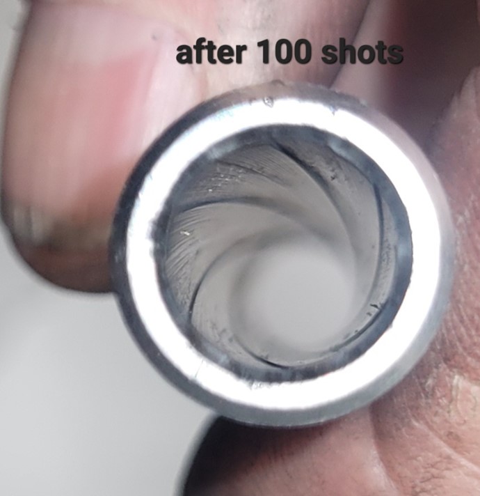

Just got back with the P89 shooting 100 shots .Shooting was mostly for function ,but at 10 yards  ten  shots rested usually stayed about 2".
Load was 4.3 4756, RP 5-1/2 LBT 140 PC sized to .356(per Aaron's suggestion) .Cases were a "dog from every town"
The throat has a wash  of gunk (not  lead )that scrubbed out with a few pushes of a brass brush.
While not a magic load or target accuracy its where I wanted to be to ring steel at our range economically.
I wanted to hate PC bullets but they seem ok

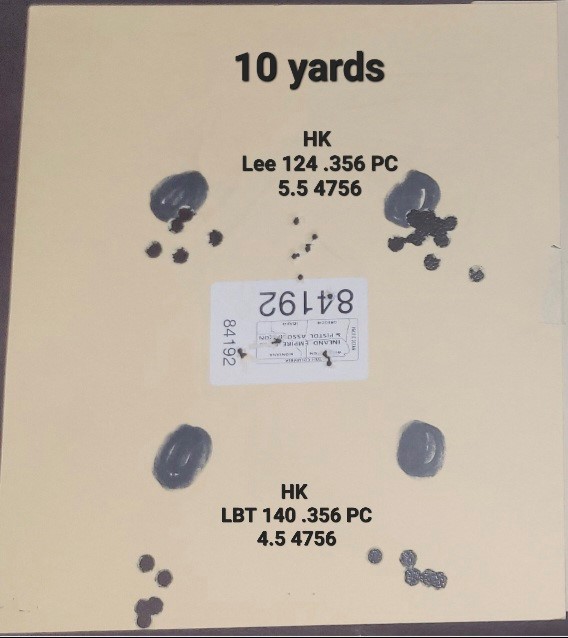

shot another 100 tonight between the HK USP 9mm Elite and my  old Beretta 92.The 140 LBT load that functioned great it the Ruger P89 didn't have enough oomph to cycle the HK and Beretta reliable but shot "ok"  with no leading.
I had some of the offending Lee 124g bullets so I sized them to .356 and used 5.5g of 4756 and both the Beretta and HK shot them very well with no leading.
So now I'm.more confused then ever? Was it bullet diameter  or the  Greendot load?
I'm not making excuses for these groups.But I was more interested in functioning and leadding  then really clamping down the eyeballs but still i'm not unhappy.

linoww posted this 09 February 2025
HK USP 9mm Elite.
Lee 124 PC .356 with 5.5 4756.Mixed brass.
No leading.
two 5 shot groups rested 50'.
one 15 round  magazine offhand 50'  ( Don't laugh at the vertical.I was really struggling with trigger release after shooting off of bags)
I let my friend shoot some of the load out of his CZ 75 and they also shot fantastic.
