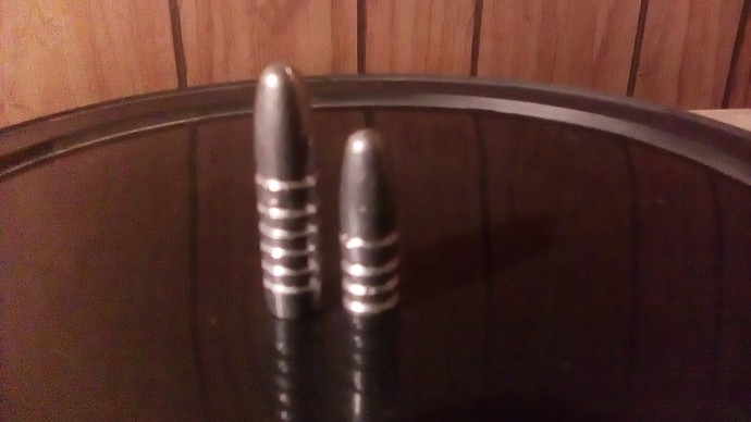

i shortened some 140gr. Lyman .266,to fit 6.5 case neck. Down from 1.117 to .825, wt. change 140gr. to 100gr. If these are accurate will have to mill mould face down, milling each bullet would take forever. Will powder coat & shoot with base wad.--Nosee
There are two basic set ups with 6.5 rifles...... military with big long throats (typical of the 266469 design) and commercial (much tighter short throat typical of the Saeco bullet). Make a lead impact slug in your 6.5 CM, it should be a short tight throat. That Saeco bullet usually shoots quite well in them.
