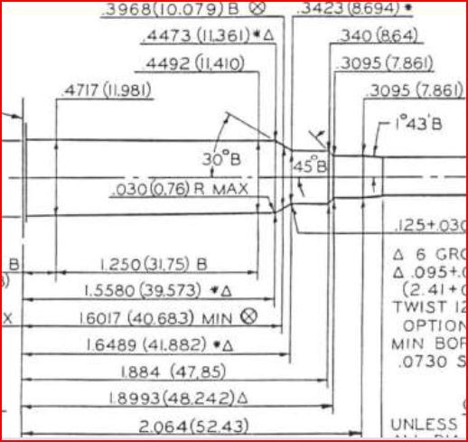

Check your shoulder dimensions, against this 300 savage drawing.
A CBA record holder, in the late 80's, early '90's (Etz Johnson) shot what he called a 1 5/8", long necked, Savage.. Short chambered, with a extended neck. I think his neck was 3/8 long.
The 300 Savage is a excellent cartridge design. I had a 722 Rem and had a Palma neck and throat reamer made to extend the OA case length to 2.03, so that I could shoot full length 308 Win cases.
I've always liked the 30 deg shoulder.

Frank: Right at the start of the shoulder this critter is +- .455 , not the    same as your schematic. the extra length over the 30-1.5 is the body and neck. Hard to tell exactly as all cases are not trimmed equal. Also this dates back to 1992. The taper of the body is different from a 308 and closer too but not the same as an '06. It's not a 30 br and not a 30-1 5/8. It's an Ardito, probably just like RMRIX's.

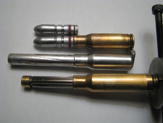

   Pic of chamber cast, 308X1.625 with bullet seated, Throating reamer with depth gauge (full 308 case). Reamer nose bushing centers front of reamer and 308 case centers back of reamer and is the depth stop.
