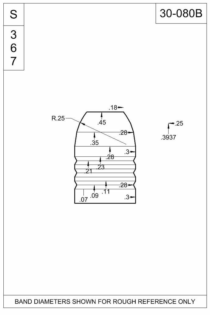

http://www.accuratemolds.com/bullet_detail.php?bullet=30-080B-D.png
Accurate Molds has a nice .300"diameter 90 gr with a flat nose that would be great for small game and it has micro lube grooves that are excellent for simple tumble lube. It is designed for air rifles.
Accurate will custom any of their 30 cal molds to .300 diameter but this one looks great for a Rook.
JeffinNZ posted this 09 February 2017
Gary, that's exactly the bullet I was looking at for the rifle; great minds!.  There is also a nice 75gr but I like the longer bearing surface of the 80B.
