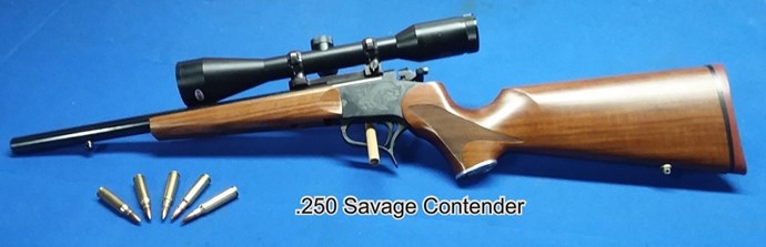

gemihur posted this 26 July 2024
My only 250 savage
I could've been a contender

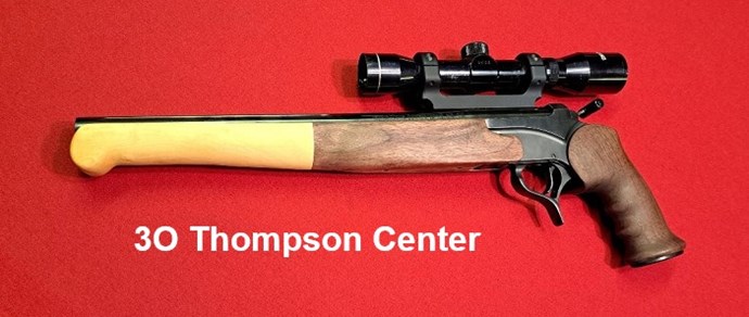

gemihur posted this 30 July 2024
kinda leggy, I know, but shoots like a dream.
