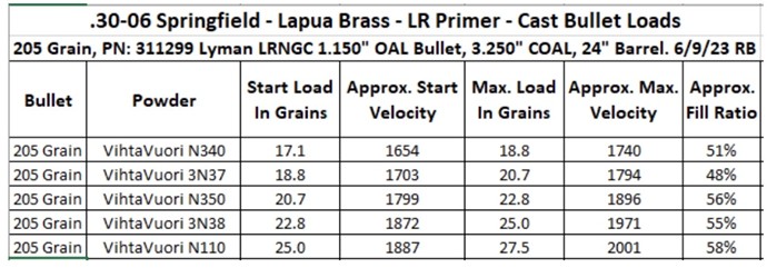

This is the reply I received VihtaVuori when I requested their recommendation for a 2400 replacement.  I requested loads that filled the case at 50%. So far the N340 at 17.1 load has shown promise.
If I can get past the current cancer problems, I'll also try the N110 loadings. I've had good results from N110 in the past for several calibers.

For some reason Bud's image disappeared.  At least on my browser it did.  Here's what came through on E mail.
I think internal ballistics is critical to shooting cast accurately**(see disclaimer below).  Duplicating the results of powders like 2400, 4759 that has the correct burn rate to shoot cast accurately at velocities in the 1600 to 1900fps range is a challenge for powder makers to come up with a formula that can be sold in the quantities they have to sell to make a profit.

Taking the 5 powders proposed by VihtaVuori to replace 2400 in the 30.06 it looks like this:
  • N340: Energy content J/g 4100, tubular shape 1.0mm x .8mm.  Originally designed for 9mm and shot shell loads its sold as compatible for .357 and .44
  • 3N37: Energy content J/g 4100, fine grain .6mm x .6mm.  Originally designed for .22 rimfire but now sold as a powder for 9mm.
  • N350: Energy content J/g 4100, tubular shape 1.0mm x .8mm. Sold as the slowest of the handgun powders as a heavy magnum handgun powder but flexible enough to be use in calibers that run from the 9mm to the .45.
  • 3N38: Energy content J/g 4000, fine grain .6mm x .6mm.  Sold as a high velocity 9mm and .40 powder.
  • N110: Energy content J/g, no data available, tubular shape 1.1mm x .8mm.  This is a dual purpose powder that has rifle load data that runs from the 22 Hornet to to the 444 Marlin.

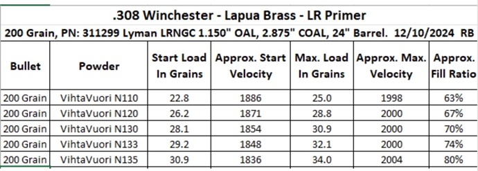

Attached is what VihtaVuori sent me regarding a request on .308 load data and the 200 grain Lyman 311299.
Once I get caught up I'll fill in results I had with the 308 using N110, 130 and 135.  What worked and what did not work.

I'm back and sorry for the delay. On 30 cal stuff I've been playing more with SW Heavy Pistol, AA9 and some Vectan I have laying around now. For N110 I have a couple. This may not help anyone much but for 30-20TC (32-20 with 308 bore) I use 8gr with a 165 gr RCBS. Note!!! This is pretty hot and only for a TC and NOT for less stout firearms. It does really smack down the Big Bore silhouettes quite nicely and even more than a typical .357. More useful will be7.7 Jap. 18 grs of N110 and either a NoE version of 316299 or Brooks 316 at 205 grs are both at 1580 fps. Case wise it will give you an idea of 308, 30-06, 8mm etc performance. The VV charts they sent out are definitely churning out more velocity than I'm looking for in Military competition.
