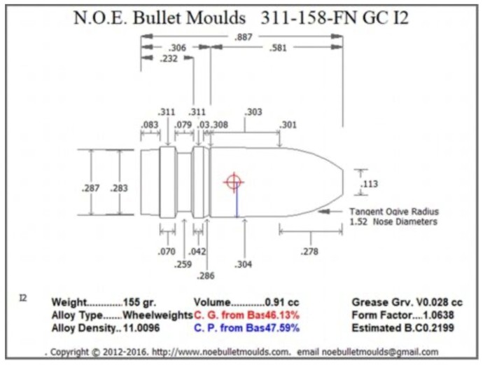

I looked long & hard for that NEI mold.  Had someone from the forum share a few samples from his mold.
The NOE mold I have comes real close.  Ed said Lee changed the nose taper of his design to make it look a bit more Buck Roger’s.  It was too long to chamber in my Ruger unless I set it real deep.

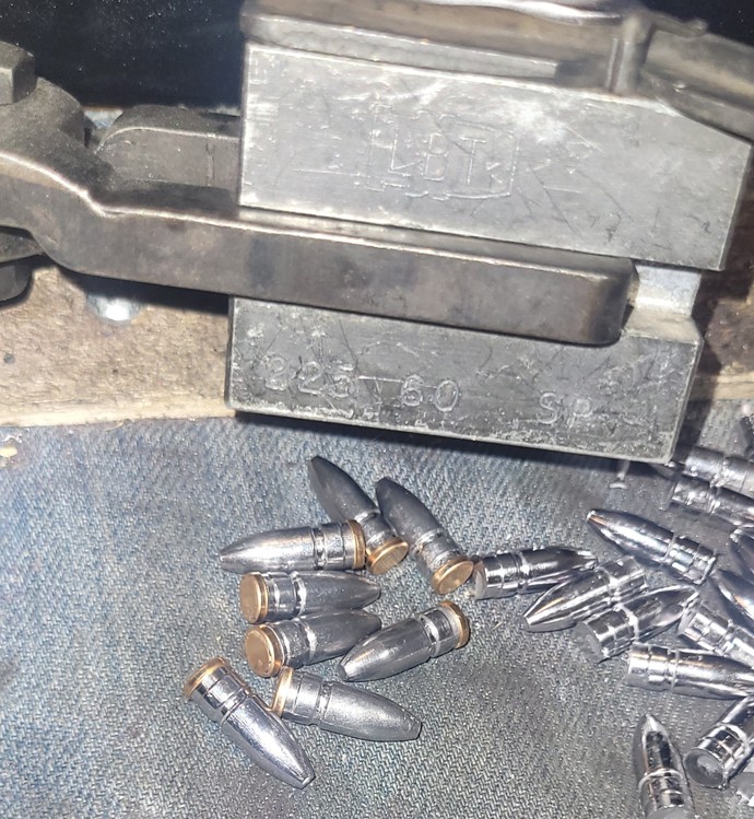

Im also breaking out my LBT 60g Veral cut me with a tapered nose that's shot some great groups in other. 22 caliber rifles.
