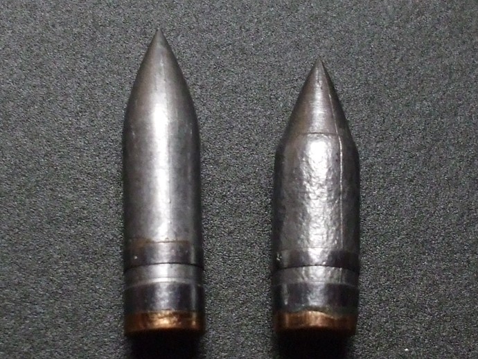

John mentioned that seating a bullet into a case that has too much neck tension can actually bump or enlarge the bullet diameter  ...especially softer alloys. Sizing bullets base first can cause this also.
Here is proof. Very little arm pressure caused this .224 caliber bullet (13bhn) to grow larger. I did this while experimenting squaring gas checks. Imagine what 20,000 psi chamber pressure could do... exiting the muzzle?
