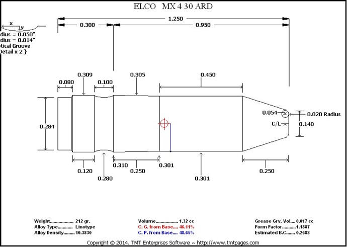

I must applozie for my tardiness of not getting back to this before now. My wife has had (not resent) a stroke and I spend most of my time at the rehab and I'm not very good at typing with my “smart” phone. What I'm trying to bring to light here, is the bullets roll in producing accuracy.
All things being equal at the bench, after leaving the muzzle, it's the bullets roll to do it's best to make only one hole. It's the shooters judgement and responsibility to aim the shot to compensate for what ever conditions may lie between the muzzle and target and this is where the wheat is separated from the chaff on the scoreboard in most cases.
I'm sure that all of us shooters have either over or under compensated for conditions for a shot and here is where I want to make my point. The ballistic coefficient of a bullet (wind bucking ability) can help minimize compensation, and there for minimize over or under compensation. In many cases by quite a lot. Also, it will minimize outliners if, your not seeing a condition, to hold off for.
For about 100 years, in single shot competition, it was said that only flat nosed bullet could produce accuracy but, starting in the 1980's, spitizers arrived and in the hands of the better shooters, they started winning matches and now, almost all match winners use a spitzer bullet. It's my contention, that the dramatic increase in scores since about 2000, is, in part a refection of the increased use of spitzer bullets. Better barrels and faster twist rates, to stabilize the longer bullets, have also played thier part. I know us CB shooters are resistant to change and, let's face it, we're cheap, too, or we would be shooting jacketed bullets into one small hole. We can, in some cases, buy a bullet mold for the price of 250 jacketed bullets. So, whats not to love about that? What I'm going to show you, is the calulated BC of different bullets and how that you can get less wind drift at slower velocity if you use a higher BC bullet. Calulated and real BC's can be different but, the trend will alway be the same. i. e. A bullet design with a higher calulated BC design will in the real world produce a higher BC at the target than design with a lower calulated BC. If that makes since. ALL bullets are made up of dimensions that produce thier shape. BC is real and it will do want it says it will in getting to the target, that being reduced wind drift. BC is a product of the differential of the vel at the muzzle and at the traget.
If a bullet leaves the muzzle at 2000 fps and arrives at the target at 1500 fps, it will have a lower BC that that same bullet leaving the muzzle at 2000 and arriving at the target at 1600 fps. BC can be increased by adding weight to the bullet or changing the nose shape to a longer ogive or both, together. We will start with the accurate and popular MX4 30 ARD. it has a calulated BC of .270, drift is 10 mph wind @ 90 deg to the bullet travel for both bullets. Started at 2000 fps it arrives at 100 @ 1725 fps, with 2.43 of drift and @ 200 it's going 1485 fps with 8.82 of drift.  Next is a popular Paul Jones mold of 32 caliber with a BC of .42 Started a 1500 fps, it arrives at 100 @ 1363 fps with 2.14 of drift and @ 200 it's going 1247 with 7.29 of drift. A drawing of the MX4 30 ARD:

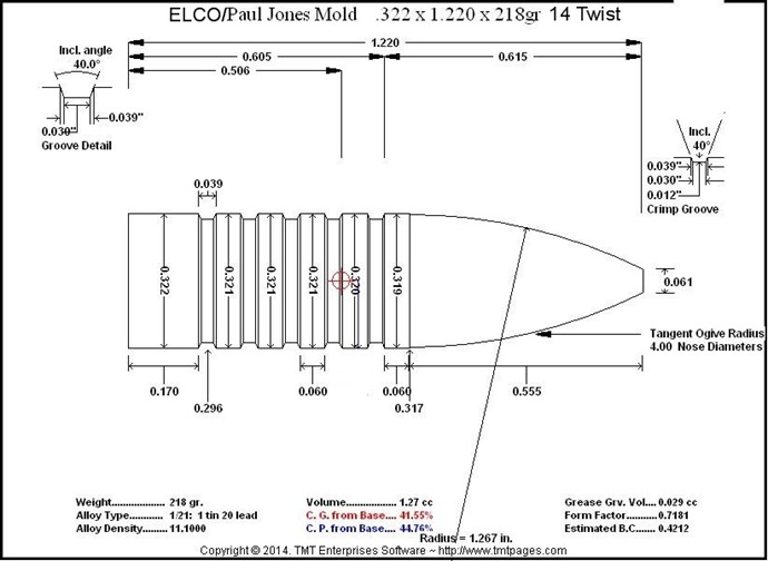

The PJ mold of larger caliber but, almost the same weight SD is less with it. .319 30 cal, .302 for the 32 cal. Regarding the calulated Vs the real BC, I've done testing with Barry Darr's M43, that measures the BC of bullets. What I have found in that testing is the the real BC's are very, very close to the calculate BC and that the real BC can be about 10% higher that calulated on some bullets. I'm NOT advocating that people slow thier bullets down, what I am advocating is that they try higher BC bullets at the velocity they are now using.  Yes, I know that you can't just go out there and buy anything you like in the way of bullet designs > but, it is something to consider when looking for a mold. And just because it has a pointy nose, dosen't mean it will have a high BC.</p>

Frnkeore, you make some excellent points and give us something to think about.
To my eye the unsupported nose of the Paul Jones bullet is too long.    It might suffice at low velocities but will be prone to tipping and yawing if you push it too hard.   There is a reason cast bullets do not have long ogives like jacketed bullets.
The bullet below has a calculated G1 BC of 0.34 despite a conservative ogive length.    10 mph wind drift at typical CBA velocities:

Certainly agree Mtngun about cast bullets with long noses at higher velocities.  They just do not have the bearing length to support the bullets long tapered nose during acceleration, especially with the faster twists needed to stabilize the longer bullet.
What looks good on paper in design does not always pan out in reality with cast bullets.  I measure the actual BC of bullets in flight with an Oehler M43.  What I've found is bullets with BCs calculated to be .290 - .30o in reality have BCs in the .240 - .250s at 2200 to 3000+ fps.  Thus with cast bullet design for HV use I've found a short somewhat pointed ogive with 65%+ bearing surface to perform best at accuracy with higher velocity.  This is why your 7mm bullet is doing well and why the 311465, 311466 and the NOE 30 XCB in .30 caliber do so well.
